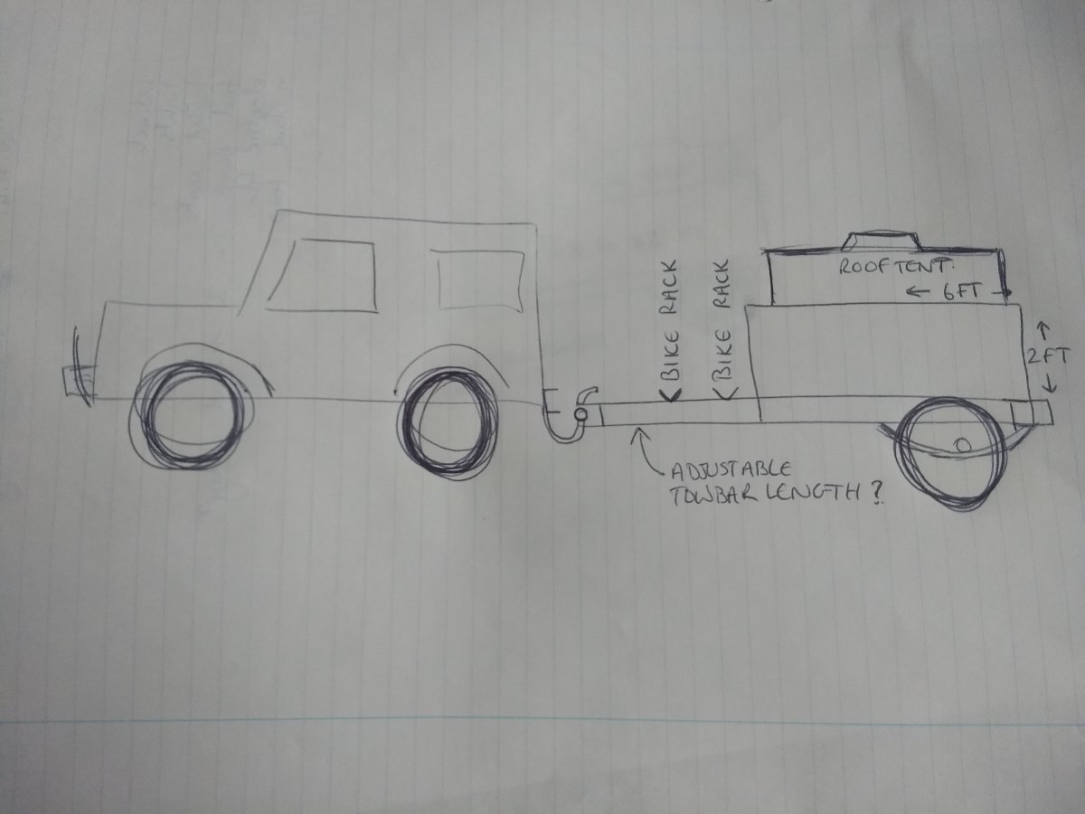

Hi all,
I'm toying with the idea of building a 6x4 sized camping trailer out of box section. I'd be trying to keep it light and simple. Preferably less than 500kg when fully loaded. With provision to mount a roof tent in the future.
This is mainly for the daily driver (Skoda yeti) but I was thinking it would be nice to have light off road ability to follow the Samurai.
That got me thinking a samurai rear axle and leafs might be a good base for the trailer that would track the samurai nicely and not look too silly or tall behind the Skoda either.
Has anyone done something similar or would you advise against it?
Thanks,
Larry

Few people have toyed with the idea. Me a few times.
Knowing what i know now, i wouldn’t use a back axle though. Heavy old lump and needs the diff leaving in. Extra drag, more fuel, lower ground clearance blah blah blah....
Two front hubs and an appropriately sized piece of tube with some flanges welded on to mount the hubs.

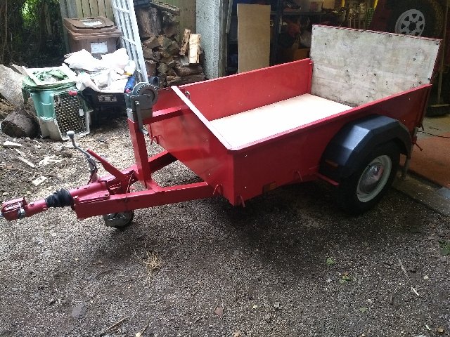

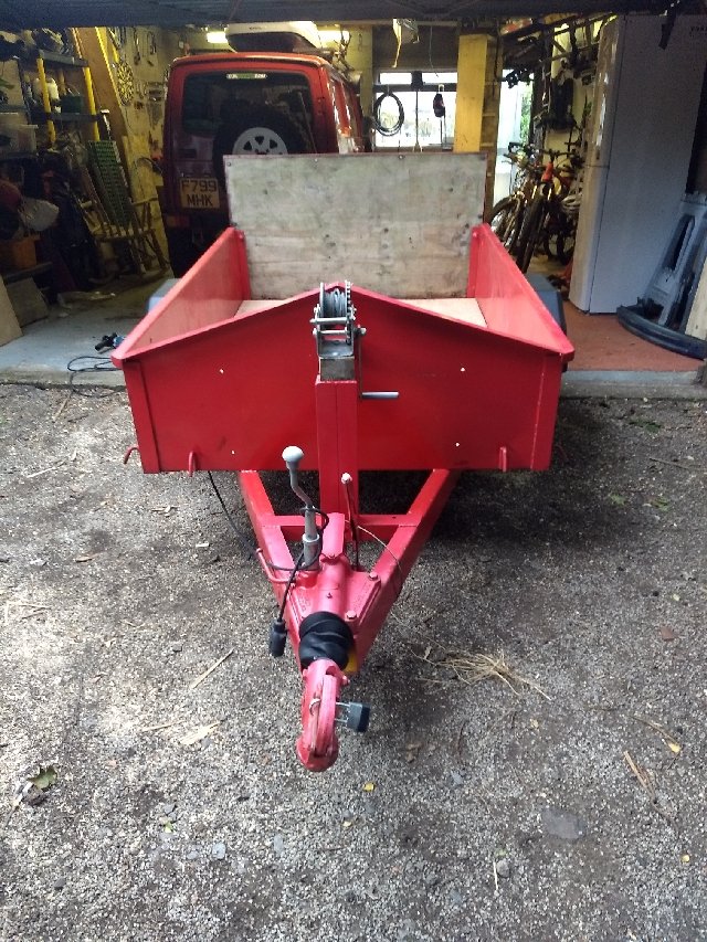

So I've kind of wussed out of building this from scratch purely on the basis that I found an absolute unit of a 6 X 4 trailer for a bargain price.
For now it's just a handy, heavy duty run about, but I'm planning to make a lid of sorts for it to make it into a camping trailer.
Off-road wise, the suspension is too stuff for a camping payload and it's braked, the mechanism hangs low between the wheels so either needs to be moved to improve clearance or at the least, protected with box section etc.
Its plated for 750kg but I reckon it's engineered for twice that.
Probably a bit heavier that necessary for the jobs at hand but it's all metal and in good condition.
