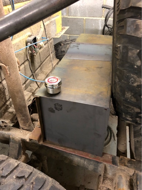

Gonna give it a bash. I’ll cut the sheet to a slightly larger size, take it to be guillotine cut to the right size and nice and square, same place will fold it to shape and cut the end caps for me.
Then take it home and weld it up, in the past i have had some pretty tidy results welding up decent new 2mm sheet. I’ll give it a whirl, fill it with water and leave it to check for leaks. Hopefully nothing more than a few pin holes and if needed to give it a 100% seal a few mates have had good results with leaky or rusty internals by using (i think) epoxy tank lining stuff.

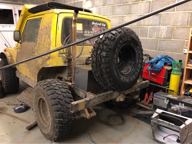

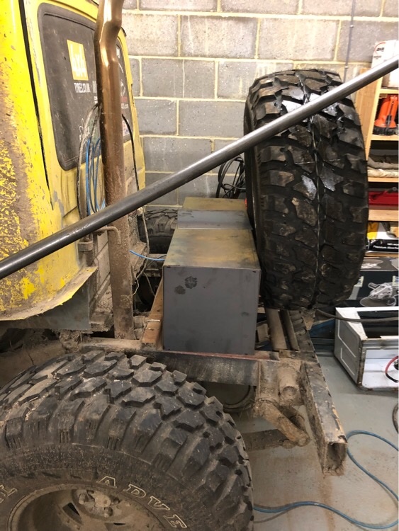

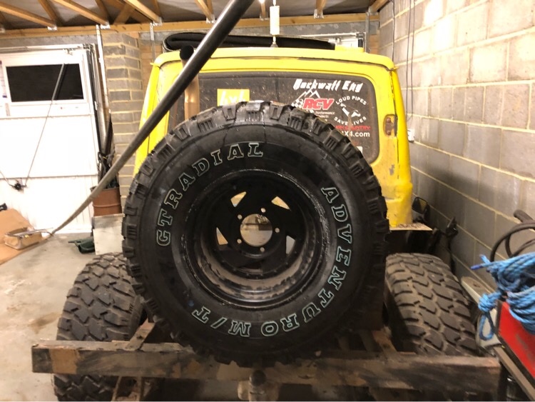

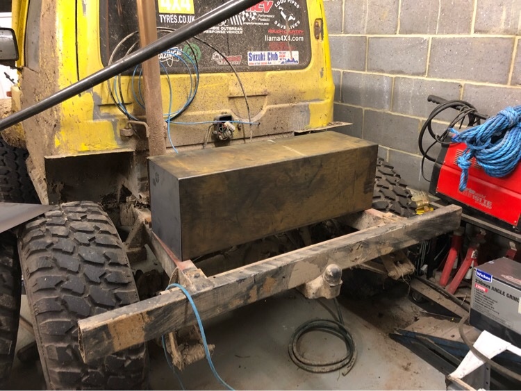

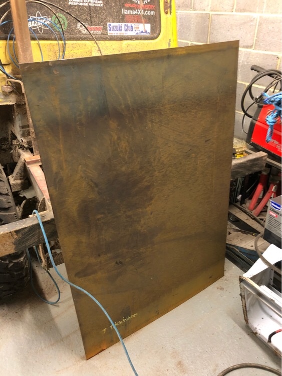

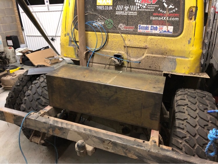

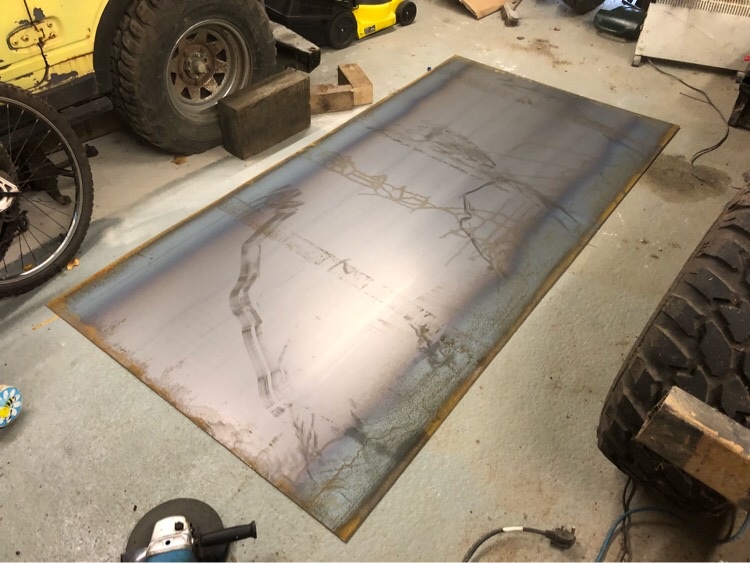

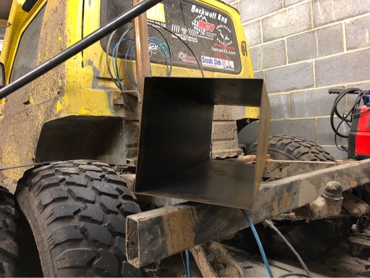

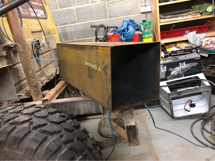

Sheet of steel arrvived this week. As did more tube.
Unexpected day off today so i cut the sheet and had it folded. Took the spare wheel and tyre and had them put together.
Then rested it all on the back of the Zuk and had a look at how i want it all to go together.
- donkeychomp
- Posts: 3583
- Location: Shepperton, Middx
That is really neat matey. And you say you can't weld....
- Jordi
- Posts: 7531
Nothings welded yet.
