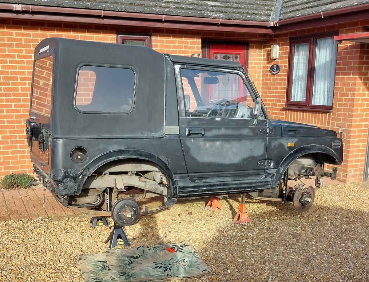

Picture today "Sammy" on the drive. Prayer mat is an old carpet runner I use, because at 81 I do feel the gravel particularly on my knees!!

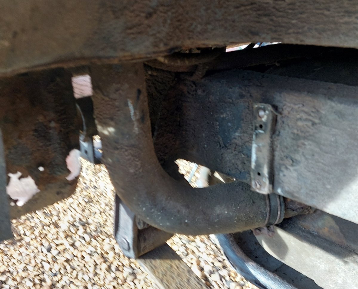

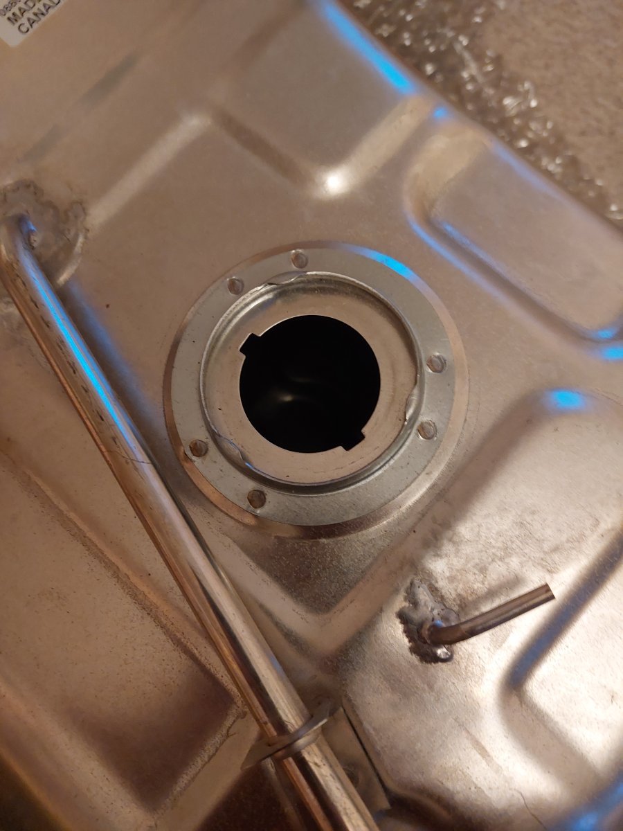

Managed to shear off both bolts on the fuel feed cover so some work needed to rectify that.

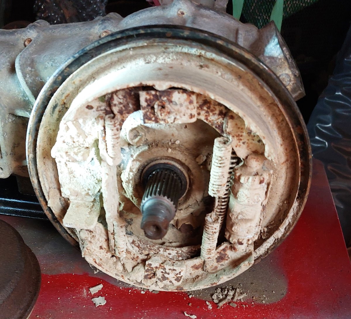

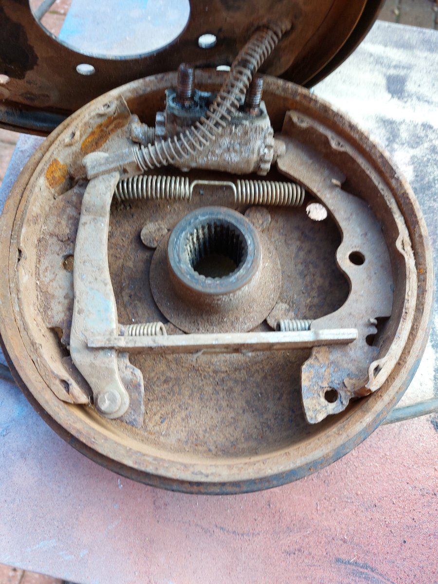

Number 6. Yes I had shown the transfer box / handbrake I purchased on a separate posting. For completeness will repeat the 'mud-trap' picture here. Effort in cleaning up has paid off and I have located replacement parts to rebuild the handbrake.

The 'mud-trap' transfer box handbrake with the drum off.

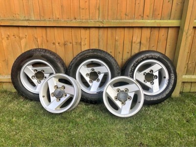

Alloy wheels I am planning to fit.
Tomorrow they will be fitted with Hankook Dynapro ATm - 205/70 R15T tyres.
Existing tyres are cracked so hand went into pocket. :|

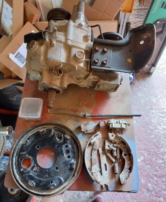

Transfer box handbrake system 95% cleaned up. Springs getting scrapped. Have purchased refurbished adjuster, new shoes and springs.
Had 'back-up'system in place, just in case.

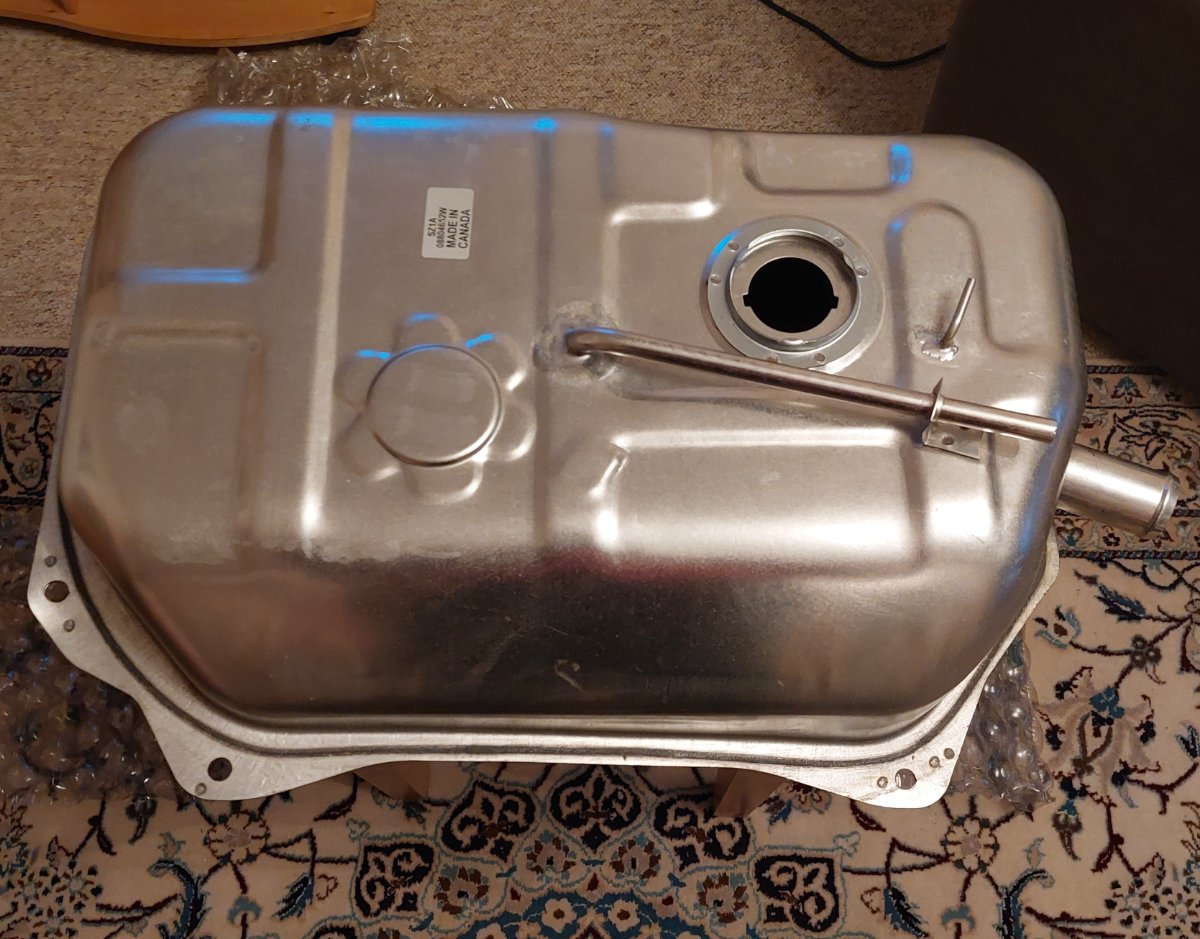

After much searching a new Spanish fuel tank was located and purchased.
