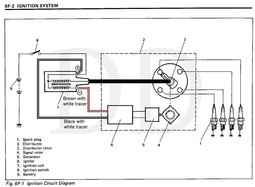

Hi there my vitara 1992 was injection now its carberetor can someone tell me how to wire up the distributor from a carberetor model ignition module and coil in a word HELP Thanks Neil :er:
Re: wiring info
Post by Darrell » Tue May 06, 2014 8:48 pm
I would just unplug the old main relay as it's not supplying anything now and connect the b/w to ignition coil as before.
vit ign.jpg (112.31 KiB) Viewed 6413 times

Hi there thanks for the info on the wireing it works fine but lost mt rev counter what do I need to get it working Thanks Neil
Re: wiring info
Post by Darrell » Sat May 10, 2014 11:05 am
Hopefully there is still the old brown with white tracer coming from the main wiring loom that went to the old coil. It came from the noise suppressor which I hope is still there, if so connect this to the coil negative terminal and see if that works.
vit inj ign.png (73.94 KiB) Viewed 6352 times

Thanks again Darrell put the wire on and the rev counter works Thanks Neil :doublethumbs:
