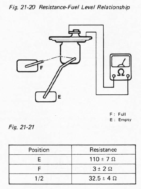

Jordi wrote:To open up my options for a custom tank size / shape I'm looking at universal senders.
Anyone know if the resistances make a difference to how the gauge reads? Yes
If so what resistance is a standard sender at full and empty? Below is from the 413 workshop manual
Also seem some with gauges but I like the idea of keeping my existing gauge is possible.
- sj 413 jap.png (169.11 KiB) Viewed 5525 times

Re: fuel tank sender resistance
Cheers Darrell, should have brought my manual to work for some light reading.
Firstly are these resistances the same on a 3 pole sender unit fitted to the later spanish models?
I have a spare single pole unit and could cobble something together, previous mine failed many years ago and I used a Landrover S111 unit (Landrovers do have there uses) a new mounting plate had to be made, mine is the one with the snap ring fitting not the 6 screws, it work quites well and was about 1/4 of a tank out which I could live with but this has now failed and was wondering if the triple pole could be swapped for a single pole?
I`m not too bothered about fuel light.
I've never worked out how to get a 3 pole sender to work in a jap Sj and vice versa, tbh I haven't really spent much time trying though. I might have a spare 3 pole sender, I'll have a look.
pretty sure they will have different resistances as they connect through the tank rather than the separate earth wire...
you'd probably need to swap a different gauge in as well
