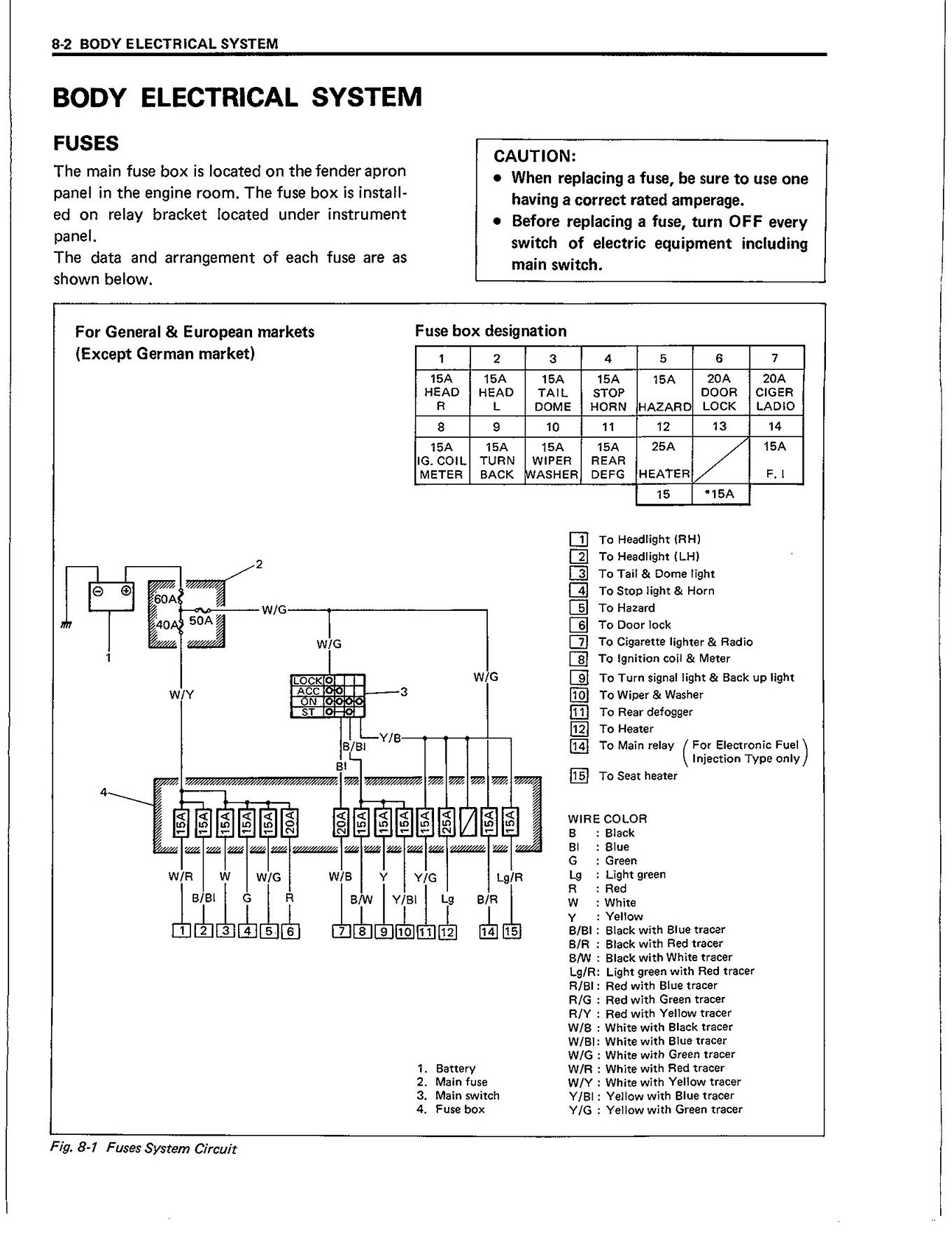

Can't find in my book wot fuse is for wot,ie no diagram,anyone help.

Should be on the fuse box cover. If not someone will come along soon with a diagram...

Yep would of thought so would'nt u,but not.

This is from the the workshop manual 1994 print. I have no idea if it's still correct for the 4u, but I can't find any more info for the later models.
If not I guess your have to pull one fuse at a time and see what doesn't work and do yourself a diagram ;)

It is marked on the lid of my 4u2, no idea where the lid is now though! I used to keep it in the glove box :lol:
