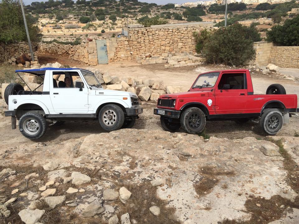

Reason I ask is because I saw this pic and had a feeling it was the same Sj
It looks like the suspension is really stiff and doesn't flex, that can't be good for handling and I would try to soften it up if I were you.
Possibly loose the coils and go back to normal shocks rather than the struts, the back could be softened up as well.
In that situation you should end up cross axled like this.
Looking at the difference in shackle angles on yours in that situation, something is limiting it, either the shocks are too short or the springs are too stiff, maybe even both.
If you can get the suspension set up better it will perform better and be a lot more stable off-road.

To emphasize, both of these were stock suspension at the time... the white one is a rental! lol
They both flex quite a bit more than that pic
