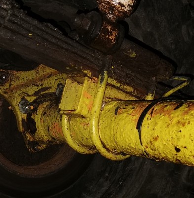

Your Sj will still be more than capable if it was back to the original spua and on smaller tyres. It's quite a bit of work to swap it back though as new perches will need to be welded onto the underside of the axle with the correct spacing for the 410 spring mounts.

I thought it was just a case of taking springs off, putting them back Under Axle then flipping the U bolts round the other way. in pic
Didn't know that anything would have to be welded on.
