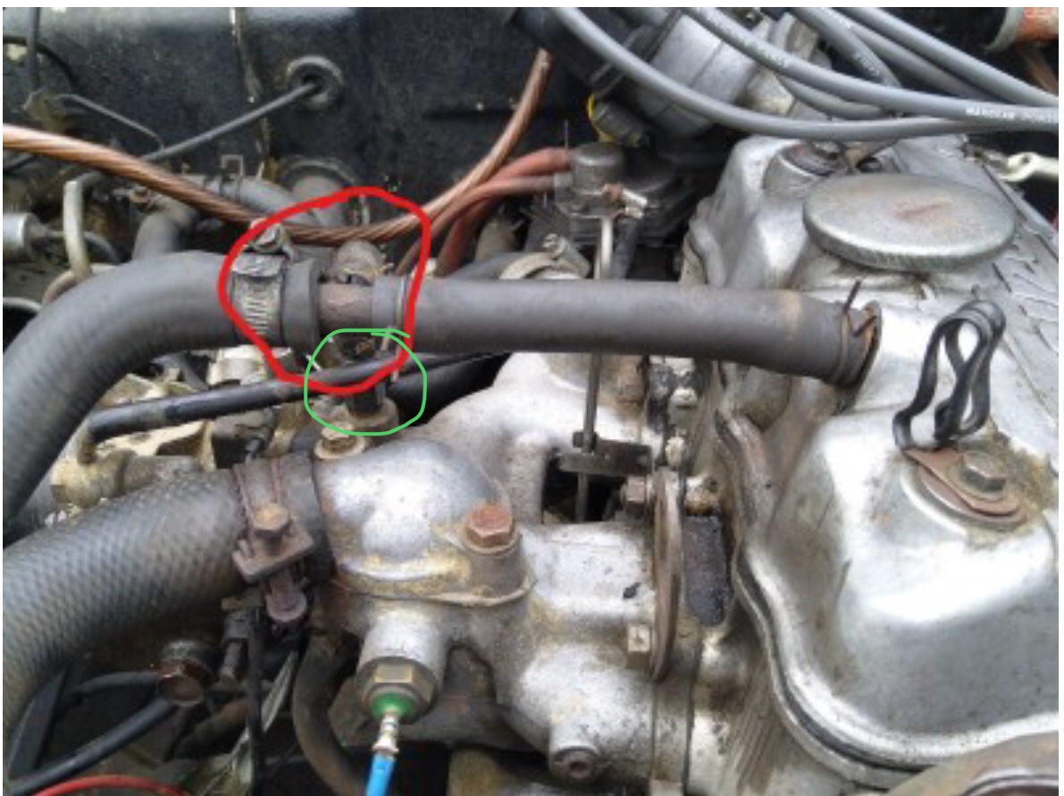

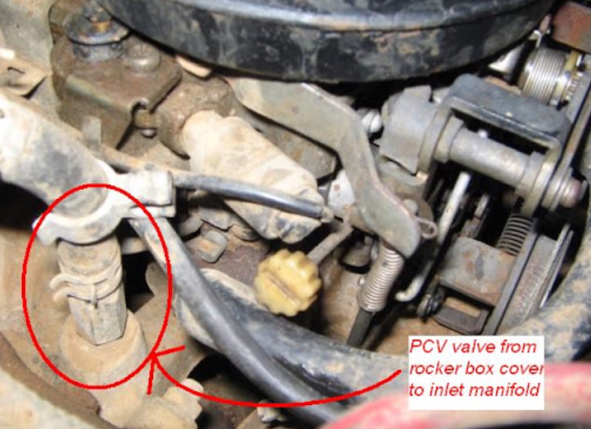

Where the short pipe attaches to the manifold, that part will be gunked up as well and need cleaning. It’s a one way valve inside, it’s a ball bearing and also a spring I believe
Re: Trouble
Thanks Mate Not sure which one you mean but will have a look,
is it shown on my pic ?

The short pie off the t piece connected to the inlet manifold. The nut looking object circled in green

The 1 litre and 800 are the same thing really, so should be something there
Re: Trouble

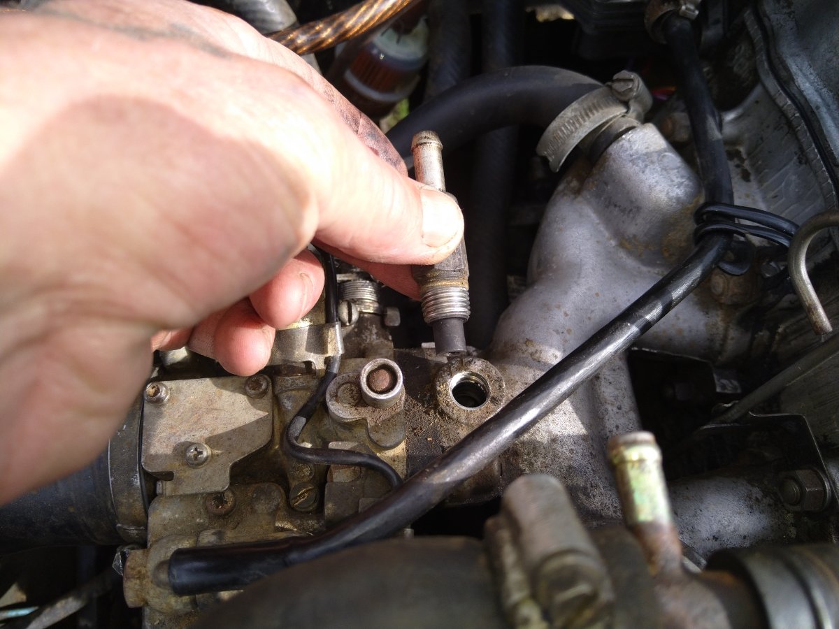

Found it Mate exactly where you circled in green above Thanks. your right it does have bearing and spring in.
Cleaned everything out again, Much Better less smoke, in fact once I get it in to 4th or even 5th as long as Im not to heavy on throttle its fine, really much better, but stil not sure if the problems solved,.

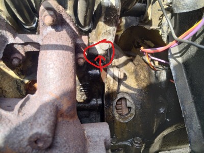

Well it has Improved but still not right, Still losing oil, think its coming from where the head joins to the block in pic, still blowing smoke on heavy acceleration ,

The leak is probably where the distributor housing is bolted to the head. Have you checked the compression on the cylinders? Could be a valve or head gasket
