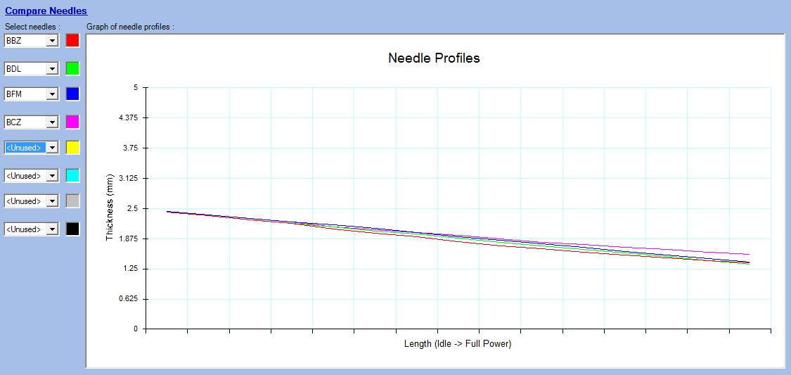

Basically with changing to the 1.6 the spring will make a lot more difference than the needle.
This bigger engine is sucking in more air to fill the cylinders, and as a result it will pull the piston and the needle up more making it a lot richer than it should be.
Regarding the needle, nearly all of the commonly used needles such as the ones you have mentioned are pretty similar in profile.... they could be considered more fine tuning and an engine should run relatively well even if it was fitted with a BCZ (leanest) when it should have a BBZ (richest)
Personally I think a BDL needle is the best place to start from as it is slap bang in the middle of the common needle choices...

ok cheers for that twiss, the needles make sence looking at it like that on a graph.
yea it smelt really rich while it was running, ive got a BDL so ill stick that back in for now and see how it goes, once i get her on the road, might just have to experiment if i have any issues.
