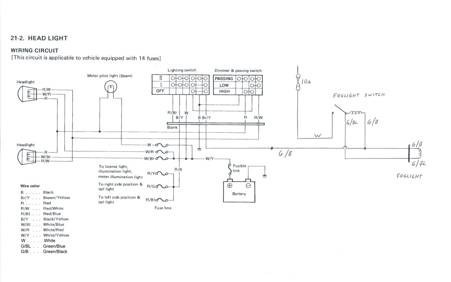

Really? I'm getting conflicting information here, and I can't find anything definitive on the VOSA website (not saying it's not there, just that I can't find it). I would imagine that if you wired them up to the dips, they'd *also* need to work on high, surely?Edweird wrote:Your fog lights should work when on dip-beam, not high beams. Some cars they actually work on side-lights too.
Anyone know what the official story is? Can I just rewire them into the sidelights and have them work on sides, dips and mainbeam, or do I have to rewire them so they work only on dip/main?
Or do I have to wire them up so they don't work except on dips?
Searching google only brought this up, which seems to suggest (under section 16) that they should work on dips.

Re: Anton's build
Suzuki wire them so they work on high or low beam.
- Headlight foglight.jpg (98.26 KiB) Viewed 6594 times
Re: Anton's build
My fog light is wired independently, its not an MOT fail but apparently would fail an IVA like that bizarrely
