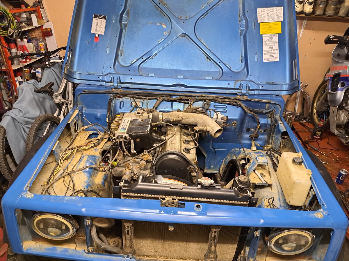

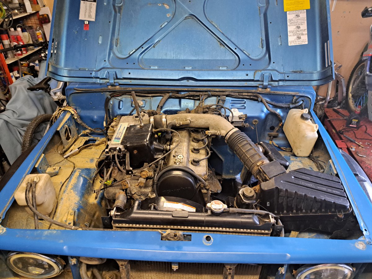

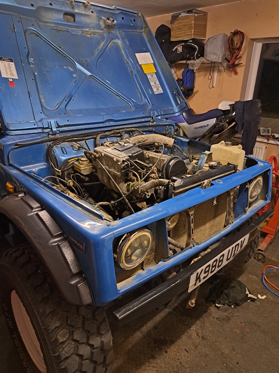

Bit more fettling and we have a front end

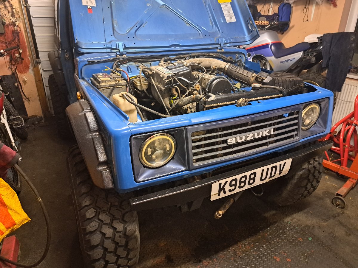

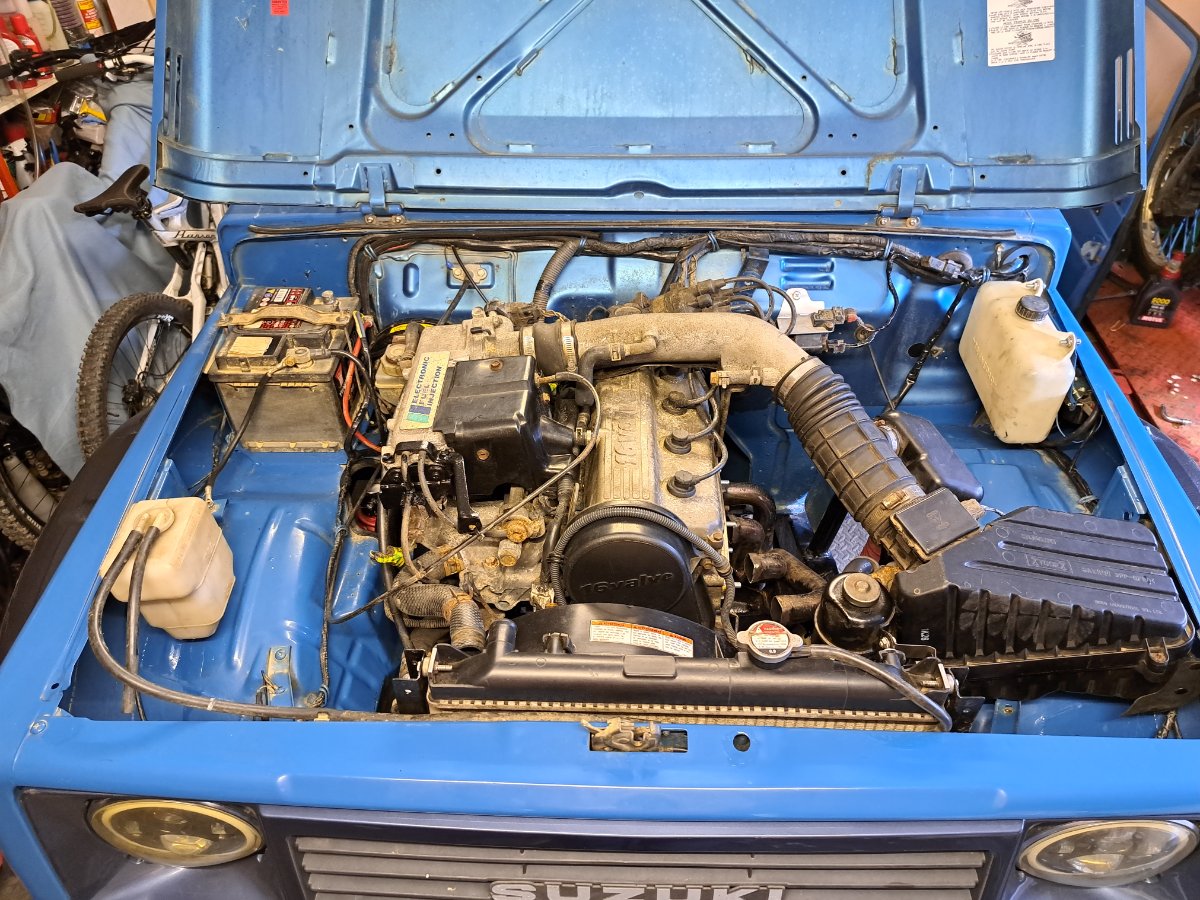

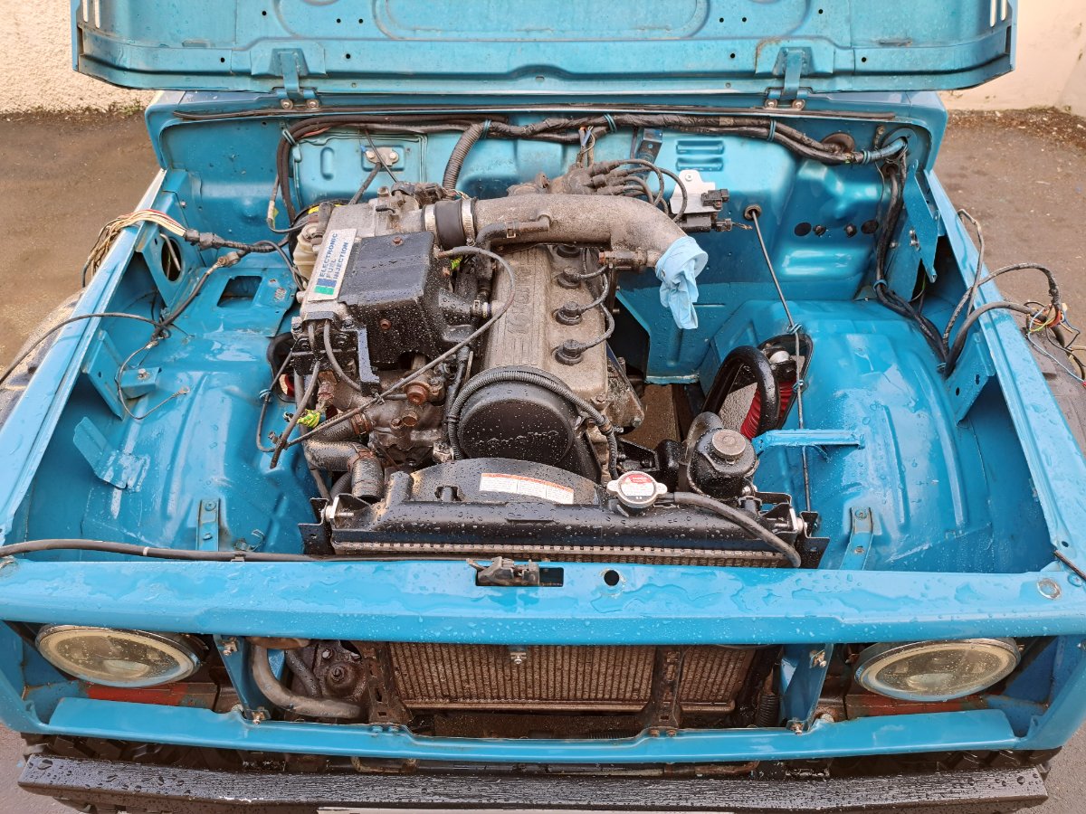

Post by d_r_1989 » Sat Mar 22, 2025 12:23 pm
Bit more chopping and it's looking more like an engine bay. Time to mock up some air box brackets
Posts: 348
Re: Coiled turqoise samurai soon to be 16v
Post by Rankine » Sat Mar 22, 2025 2:41 pm
Looking good man. Is that the factory box to?
How long till you can crank it?
d_r_1989
Posts: 575
Post by d_r_1989 » Sat Mar 22, 2025 5:16 pm
Thanks mate, everything I'm fitting is all from the vitara donor so it's all oe.
Haven't connected any wiring yet, was mounting everything so when I do the wiring it will all be made to measure and again look oe.
Apart from the exhaust manifold, I'm wanting it to look as factory as possible.
My aim is to have it done by the end of April
d_r_1989
Posts: 575
Post by d_r_1989 » Tue Mar 25, 2025 10:12 pm

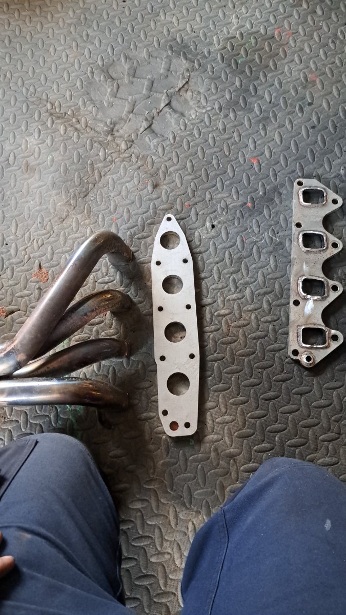

Exhaust manifold will be left with my friend to tig weld, time to start on the wiring now everything is mounted.

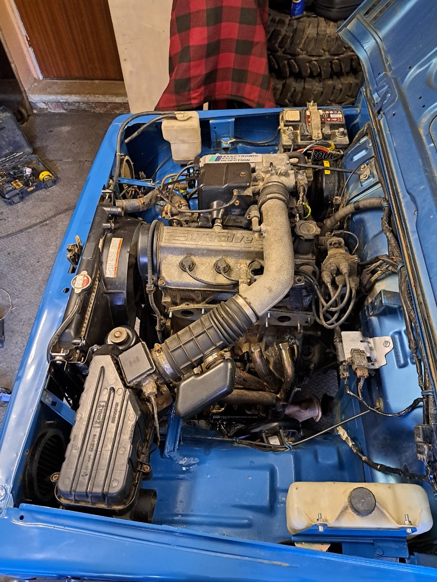

d_r_1989
Posts: 575
Post by d_r_1989 » Fri Mar 28, 2025 7:56 pm
Thanks both!

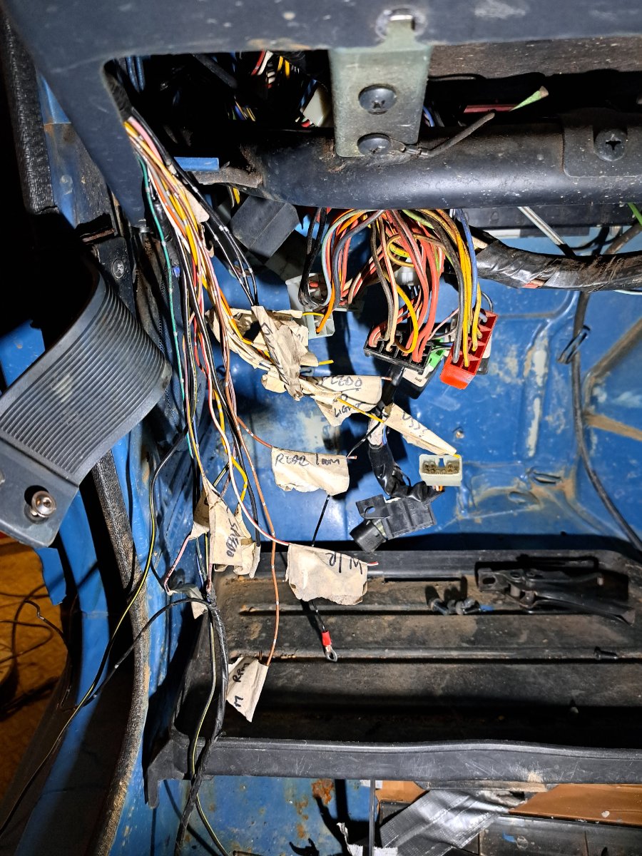

Engine bay wiring is done and everything plugged in.
Ecu is mounted behind glovebox and a few remaining wires behind dash to connect

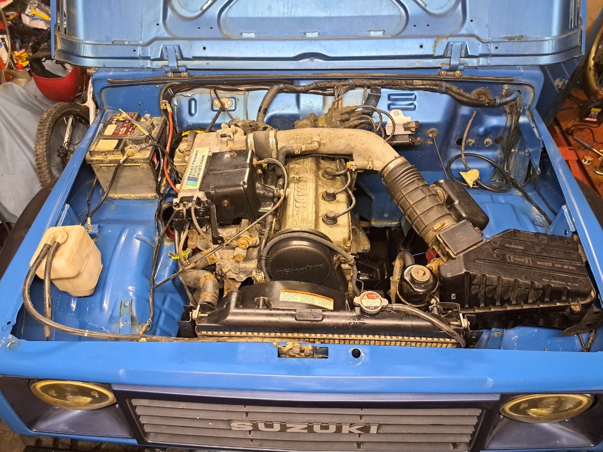

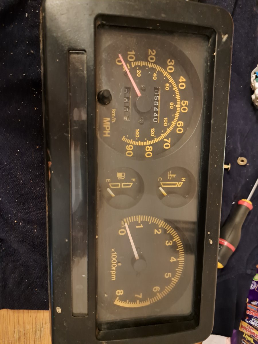

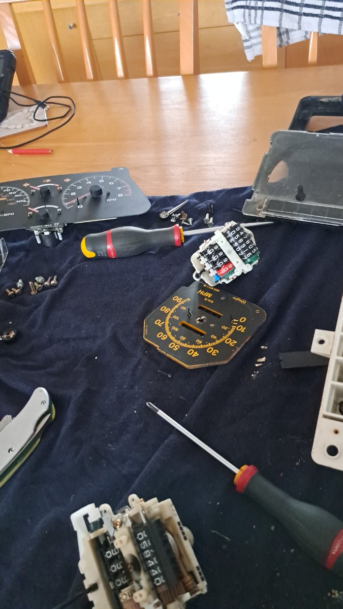

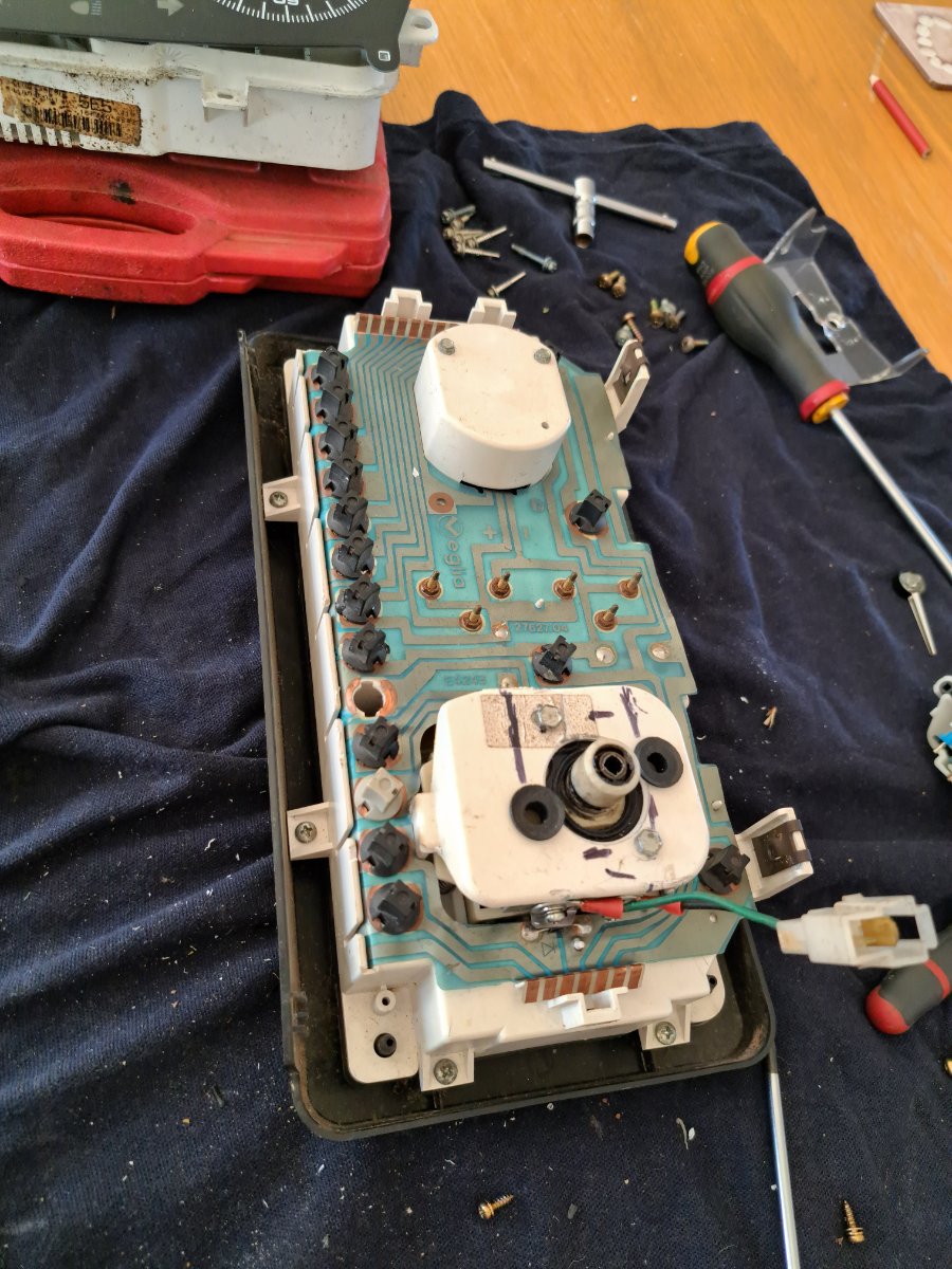

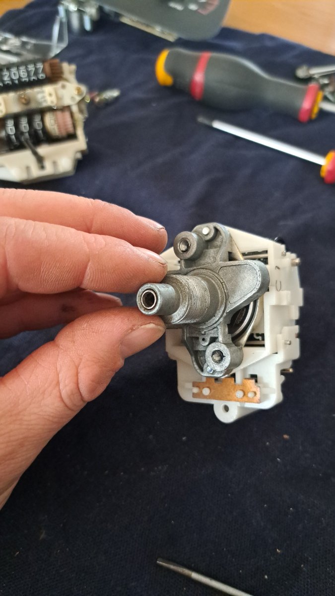

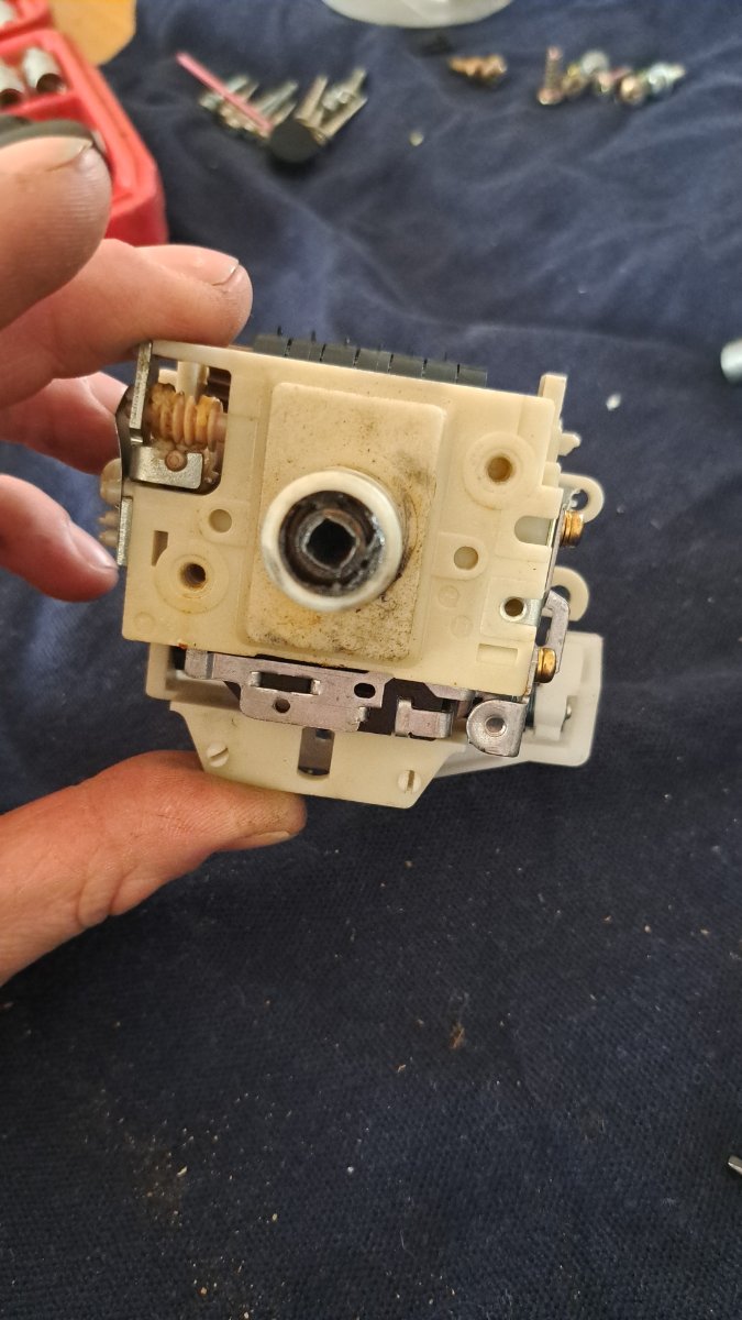

Post by d_r_1989 » Thu Apr 17, 2025 5:03 pm
Vss installed. Actually used the whole vitara speedo bit and mounted inside the sj housing. Added the 2 wires to a connector, one for vss the other for ground.
Engines now completely piped up and water tight. Exhaust manifold and fuel pump to do.
