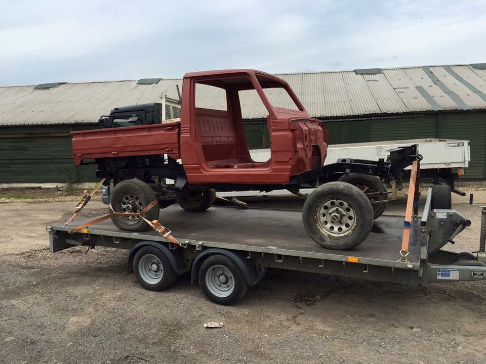

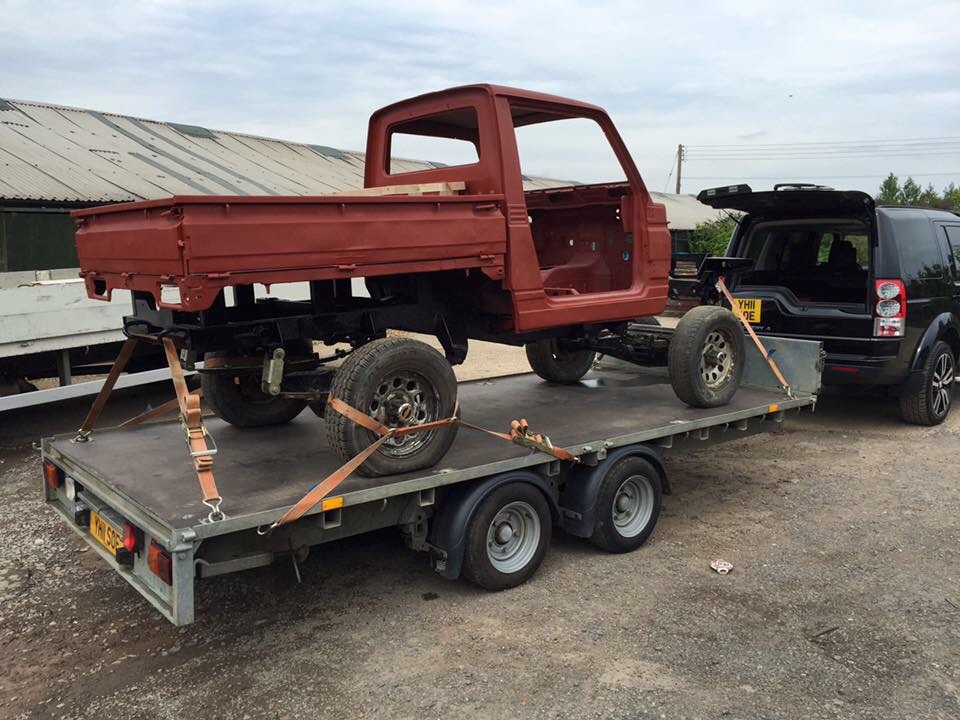

Long drive this Saturday afertoon to go see Mr Richard, he's going to cage it over the coming weeks, can't wait !
Then when it comes back il be on a mission to sort out the bodywork and painting it before assemmbly resumes !

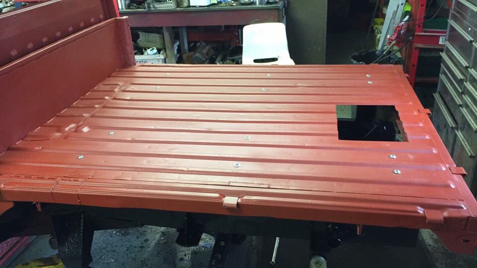

I've used some flat headed alen key bolts m10 to secure the bed down with, they look Alrite I recon

Rear bed can't come of when cage is on, so need to make the hole in the bed big enough to pull a whole winch through.
