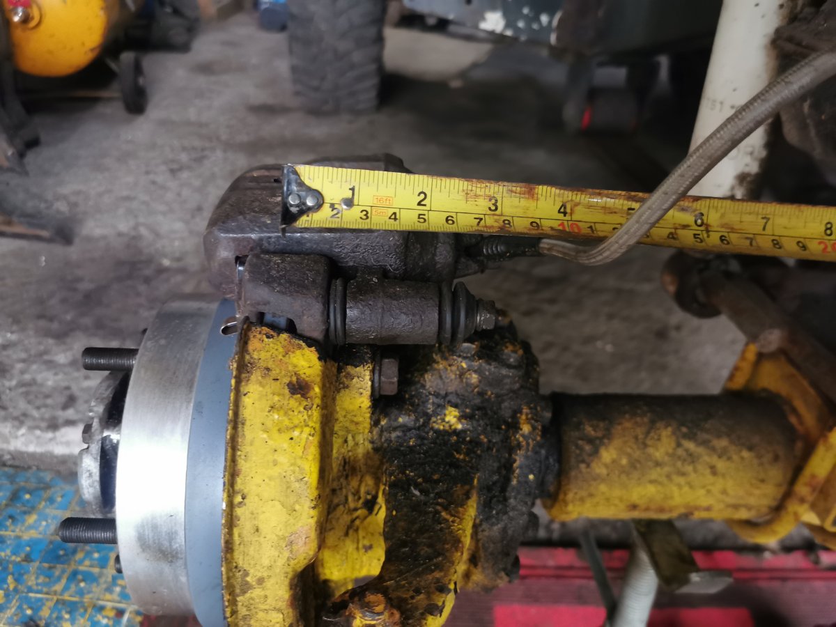

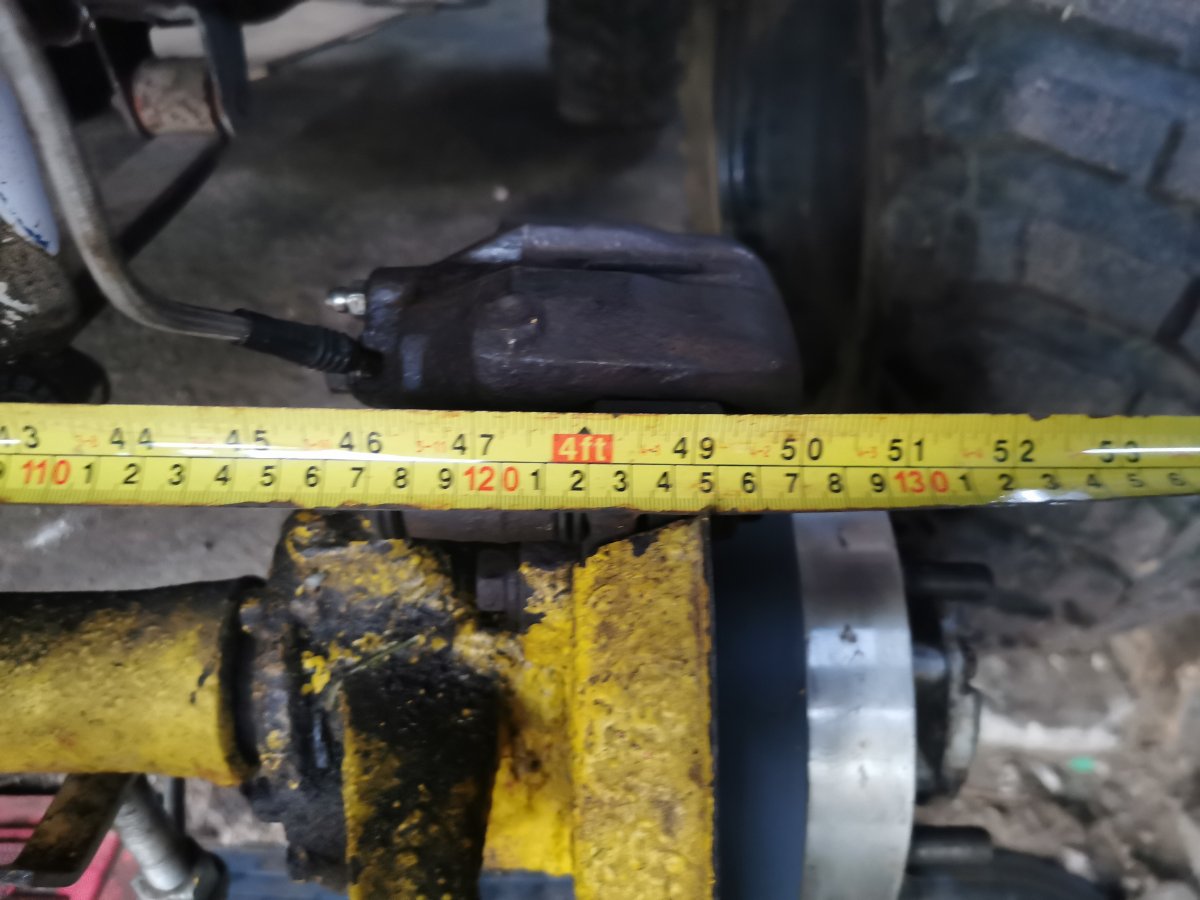

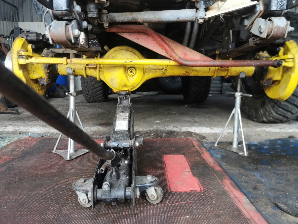

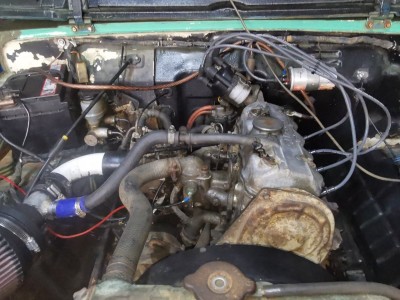

More pics, I measured from the edge of backing plate where they join the hubs either side, not sure if that was right or not. So am I right in thinking they are 48.5 SJ ?, Took more pics of T box and engine if anyone can gather more info.
d_r_1989
Posts: 575
Re: Help Please
Post by d_r_1989 » Wed Oct 21, 2020 8:43 pm
From where you circled in red i think it is, so that would mean samurai axles. Send a pic of engine
OK So maybe measured wrong then as there is a gap between there and backing plate.

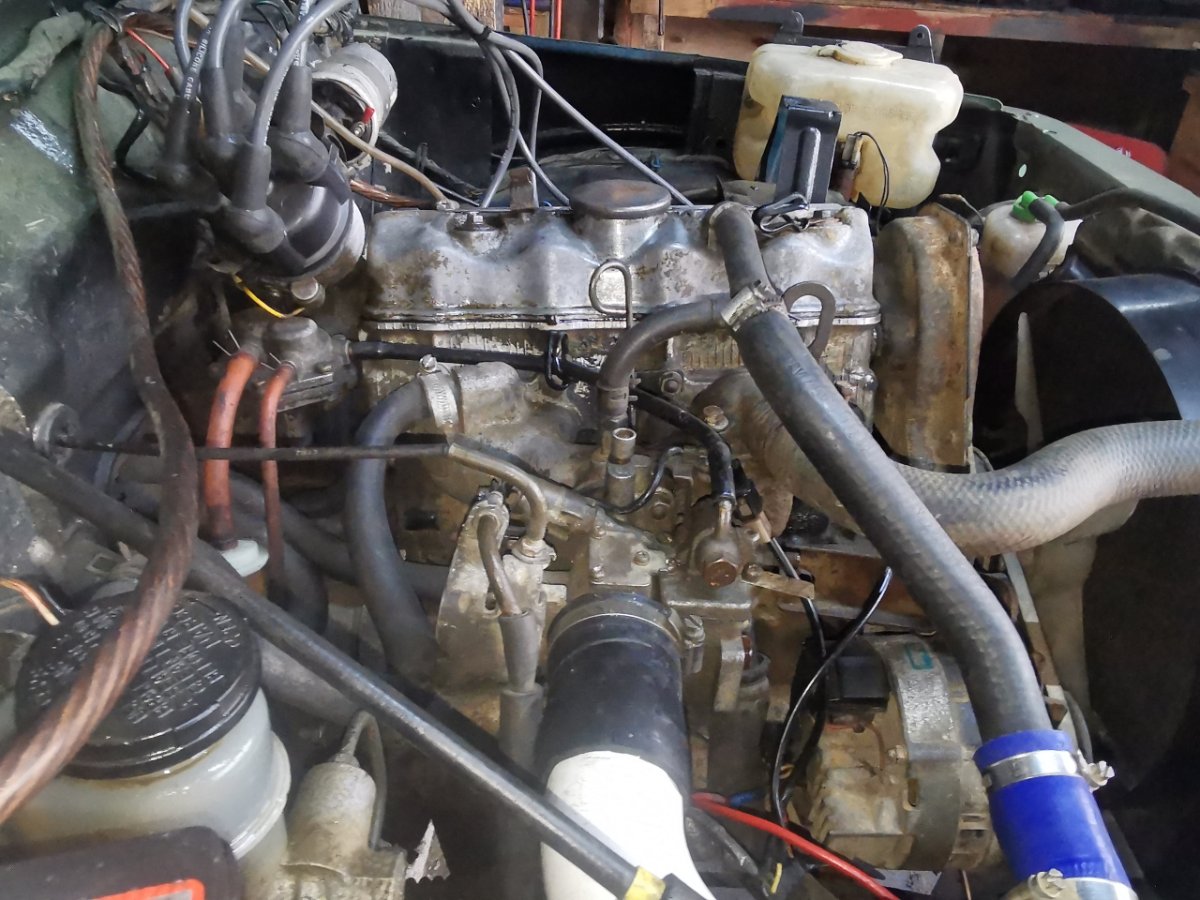

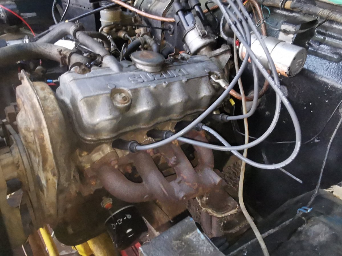

Do the pics tell you anything as to what axles I have. Here is couple of engine.
Thanks for your help.
d_r_1989
Posts: 575
Re: Help Please
Post by d_r_1989 » Wed Oct 21, 2020 9:04 pm
Its a 410 engine, the axles look like samurai axles and regardless what diff you have (3.7 or 3.9) it will be very sluggish. Your next step is vitara 5.1 ring and pinions or an engine swap. Neither are as straight forward as a straight swap but both relatively easy

If its a 5 speed, a 1.6 engine swap wont be too hard or costly. To be honest, if it turns out they're 410 axles which im certain theyre not, then its harder changing to samurai axles than it is to change engine.
Samurai axles on an sj certainly help with stability and flex, so there might be a silver lining for you

At a guess id say it was a 410 to start with, then someones added the samurai axles while doing the spoa conversion.
Its abit of a mis match but now you know whats what it will make a good easy project into something awesome

The leaf springs were originally under the axles, the previous owner has fitted them on top of the axle which creates around 4 to 5 inches of lift.
