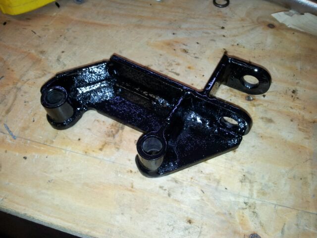

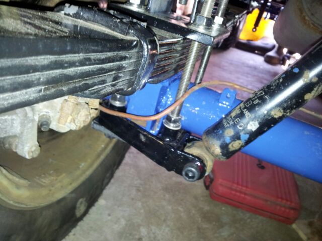

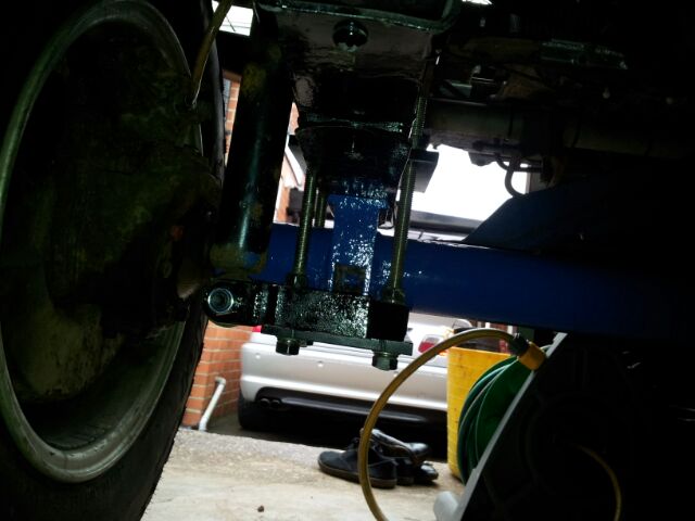

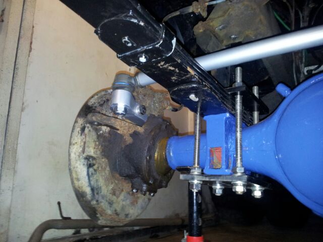

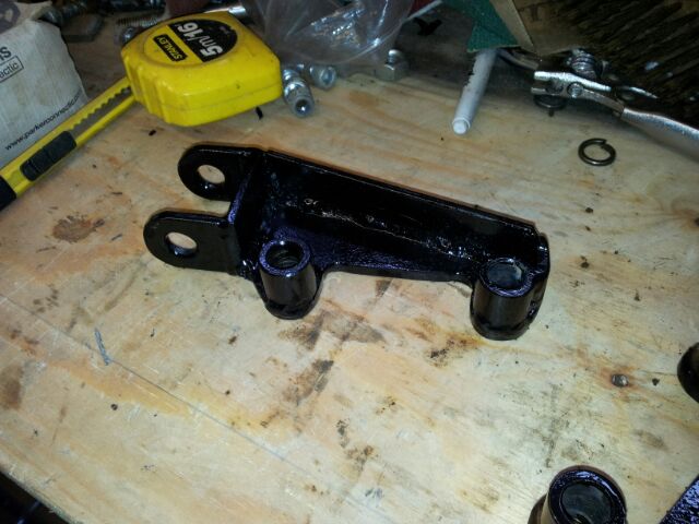

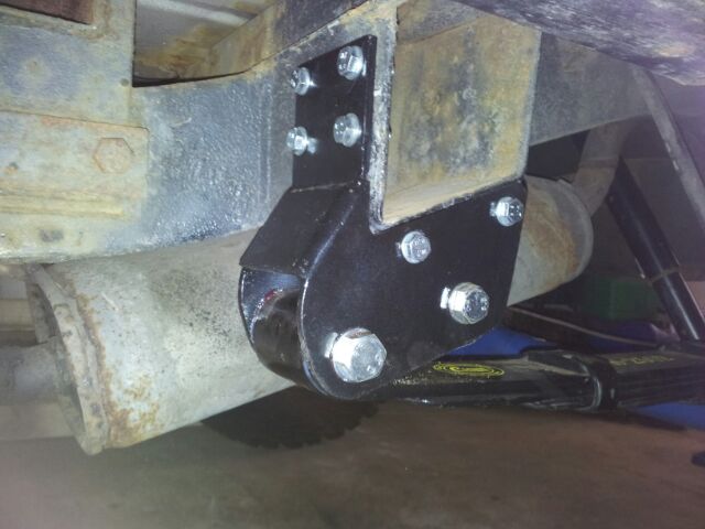

Firstly drilled the anti rotate holes in the rear mounts.
Then I made mounts for the bottom of the front and rear shocks
And then fitted them
Re: 1991 Suzuki Samurai build
Post by dan_2k_uk » Fri Sep 13, 2013 8:14 pm
Na never finished. ;)
Superb shock mounts :thumbup:

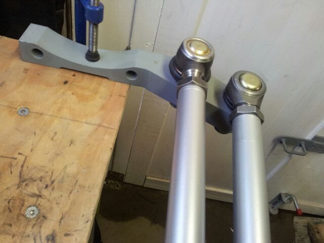

Post by gp7186 » Sat Oct 26, 2013 3:33 pm

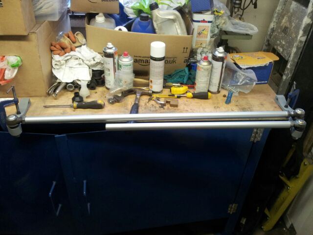

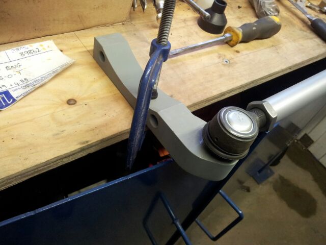

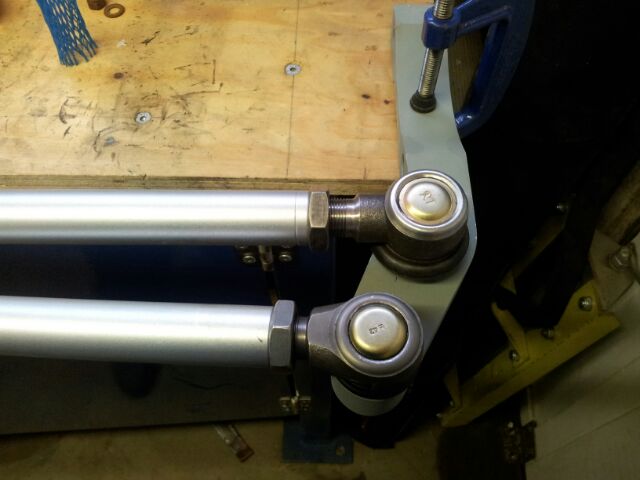

Right time now to revisit OTT steering as previously shown arms have been machined and now its sitting at the height I wanted ive now measured up the tie rods. I am using ford transit track rod ends with a m20x1.5mm thread both left and right hand to create a tracking rod then the other will be transit one end snd standard sj the other. Heres some pics of it on the bench just got to fit it now
Post by Jordi » Sat Oct 26, 2013 4:33 pm
That is super tidy!
Post by turbo-tom » Sat Oct 26, 2013 6:03 pm
Very tidy.

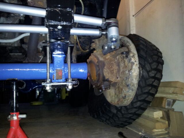

Post by gp7186 » Sat Oct 26, 2013 7:04 pm

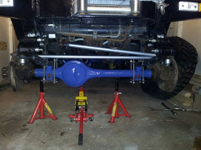

Thanks for the comments, I had a bit more time today than I thought so I fitted it
dazerede
Posts: 2141
Location: cornwall callington
Post by dazerede » Sat Oct 26, 2013 11:17 pm
Wow u have done a realy nice job on.this sj
