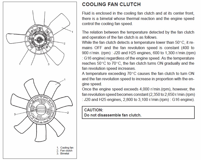

Reading through that it sounds fine to me.
My 1600 gets up to temperature in a couple of miles.
It should have a viscous fan.
The fan will spin with the engine but at a reduced RPM until the engine gets hot.
When this happens it will pick up speed and you will be able to hear it.
The fan should come up to speed about where you say it did (top of the white band).
As said the other fan is for the air-con condenser and will come on as required when the air-con is on.

Re: Fan Question
Post by Darrell » Tue Apr 29, 2014 9:24 pm
ipbr21054 wrote:Standard type.
Not the type which has the coil affect spring inside.
When I got home and popped the bonnet I spun the fan quite easy.
You cannot spin the fixed type fan and you should have the spring type :er: , are you sure ;)
