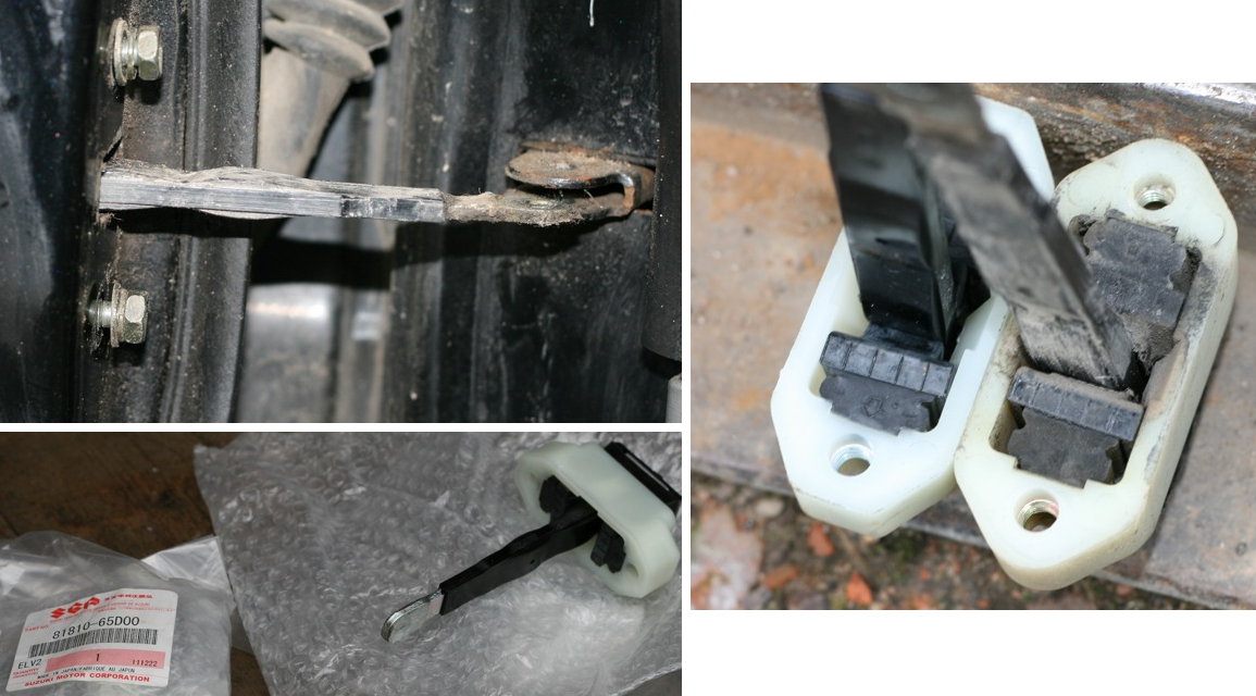

Re: Doors refusingto stay open
Yes it should stay half open or fully open (dependant on the wind giving it a shove).
I "googled" the part number and it appears they can wear quite badly being plastic. I remember when they used to use spring steel clips on most cars and bloody awful noise they used to make because people couldn't be assed to oil them.
The pictures quite clearly show the wear and the ridges/bulges that position the door opening.
