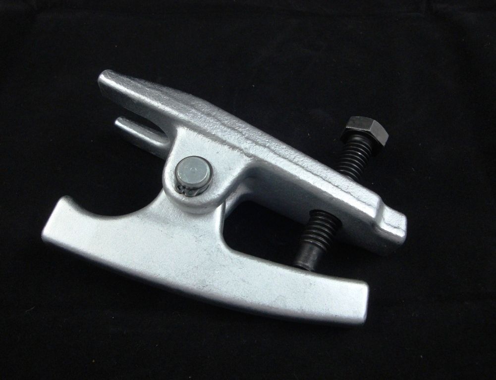

Thank you..!!!! Looks like I'm going to need a puller tool so may be easier just to take it somewhere..??
Re: Front Coil Spring
Think you only need a joint splitter and they aren't very dear. That's what they are calling a puller.
About a tenner for one like I use..
