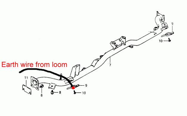

Re: electrical gremlins
On my Jap built 413 the main loom earth is on the passenger side. It's quite a large black wire that comes from the loom and is fixed to the metal plate bolted to the dash tube/bar. However the must be joins from this wire to other components IE instrument panel. I have no idea if these are done inside the taped up sections of the loom or if there is joins behind the dashboard somewhere.
- Loom earth.jpg (23.17 KiB) Viewed 8735 times
