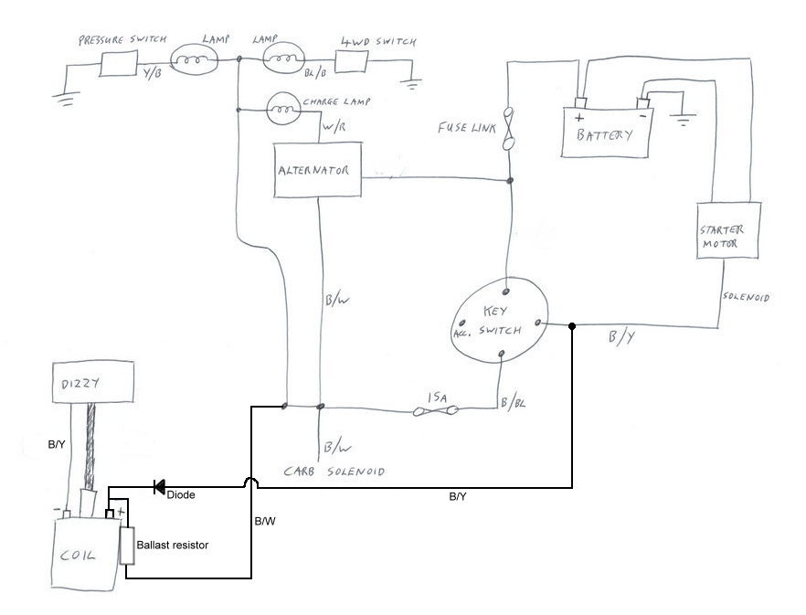

looking a turf and the wiring is a right mess, so i'm thinking off ripping it all out and starting again.
so the question is what wires dose the engine need to start and run?
live to the coil, live to the starter pluss trigger wire from a switch wire from the alternator?
not sure on the dizzy do these have points? or electric ign?

what one is it? a 410 will have points, a 413 doesn't. i think the 413 dizzy is just a little sensor that does the same job as points though so its similar to wire up. someone here will know:)
Re: what do they need to run
Post by Darrell » Thu Apr 25, 2013 10:45 pm
I scribbled this out before for a 413, its up to you if you want the oil pressure and 4wd light.
The 410 will be a little different as it has a wire bypassing the 410 ballast resistor.

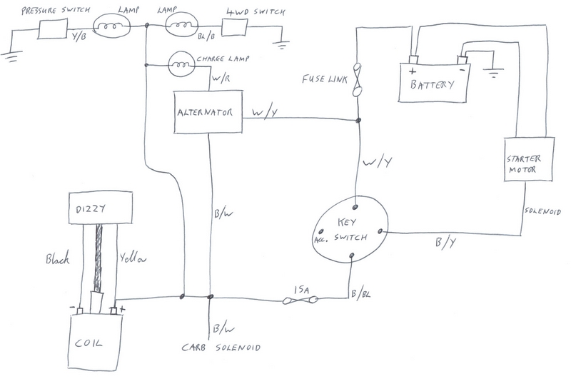

thanks guys sorry its a 410

Modified for a 410 (I hope :oops: . As usual, if anybody sees I've screwed up please say so :thumbup: )
410 minimal wiring.jpg (45.63 KiB) Viewed 7092 times
The alternator wiring may be different if you have a early 410 with the voltage regulator not built in.

thanks mate i thought the alt and starter were connected buy thicker wire to the + terminal?
Post by Darrell » Sat Apr 27, 2013 10:58 pm
They are , that's just the diameter of my pen :D

any better ;)
