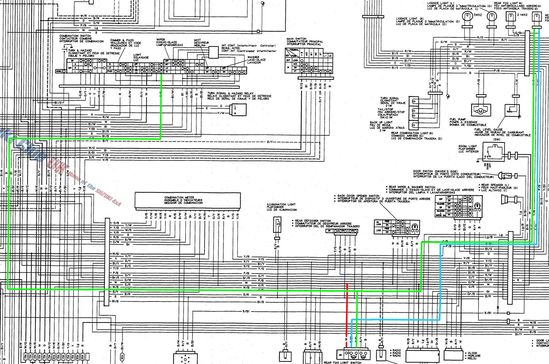

Looks like the fog light is wired the same as the SJ.
Vitara foglight circuit.jpg (925.83 KiB) Viewed 9068 times
Red is live supply
Blue is switched live supply
Green is switched earth (only connected when the headlights are on)
Yes I believe the 4u2 didn't have central locking so without knowing how that's wired in I can't help, sorry.

still no joy with the fog light
does anyone know what colour wires that have going to their fog light, mine are green/black and green/blue.
i also seem to have 2 fog light switches?, i assume one was for the front fog lights? it has a large off button on it.
i have disconnected the central locking now the solenoid does not click every time i switch on/off the lights!
shaun
