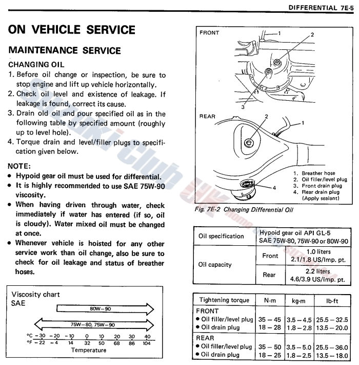

Post by Darrell » Mon Oct 07, 2013 10:18 pm
more info
Vitara diff oil.jpg (127.71 KiB) Viewed 4721 times
