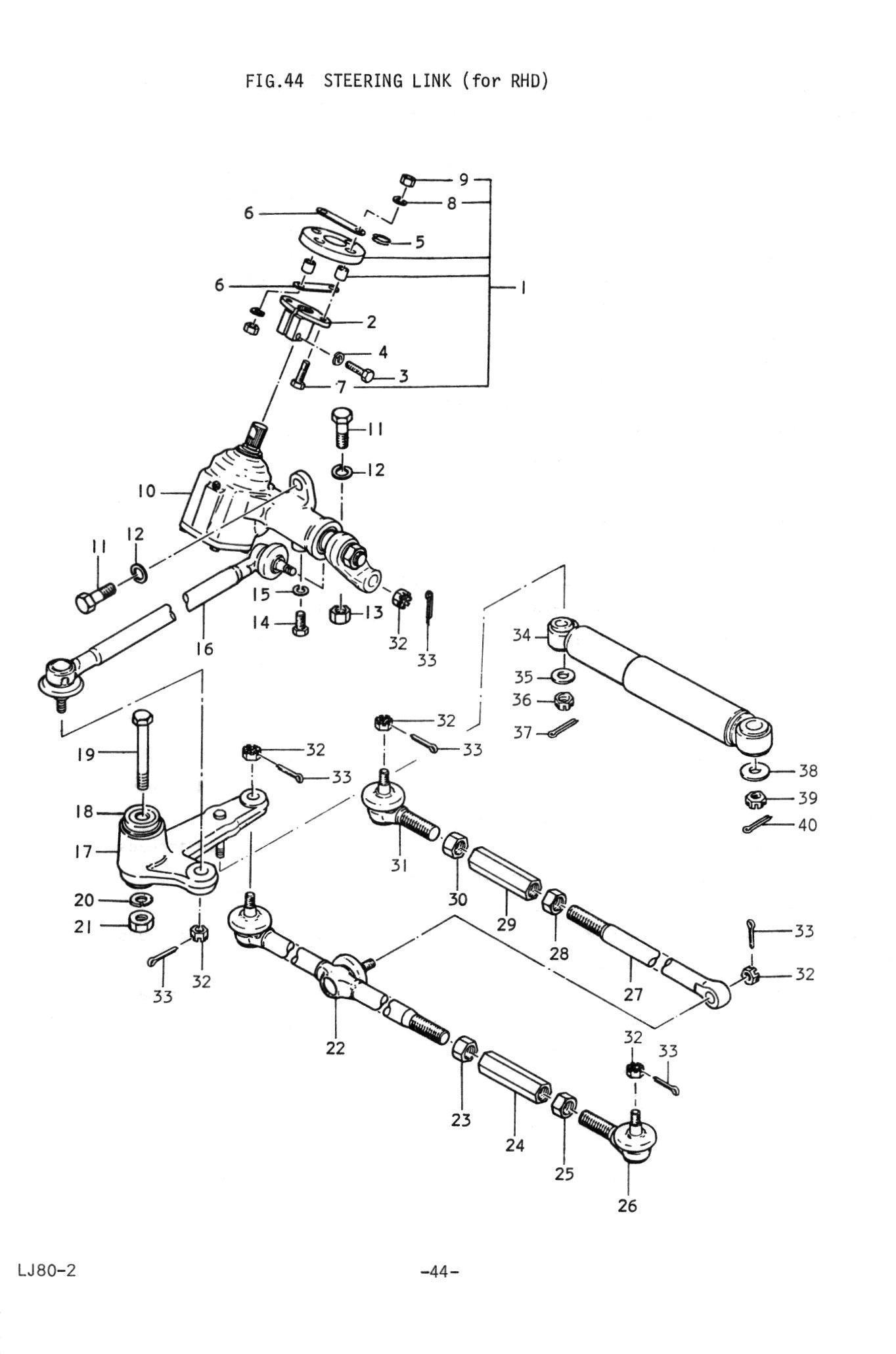

Is that supposed to be part 16 :shock:
LJ steering.png (658.41 KiB) Viewed 6924 times

Post by ROBBIE » Thu Dec 07, 2017 9:15 am
