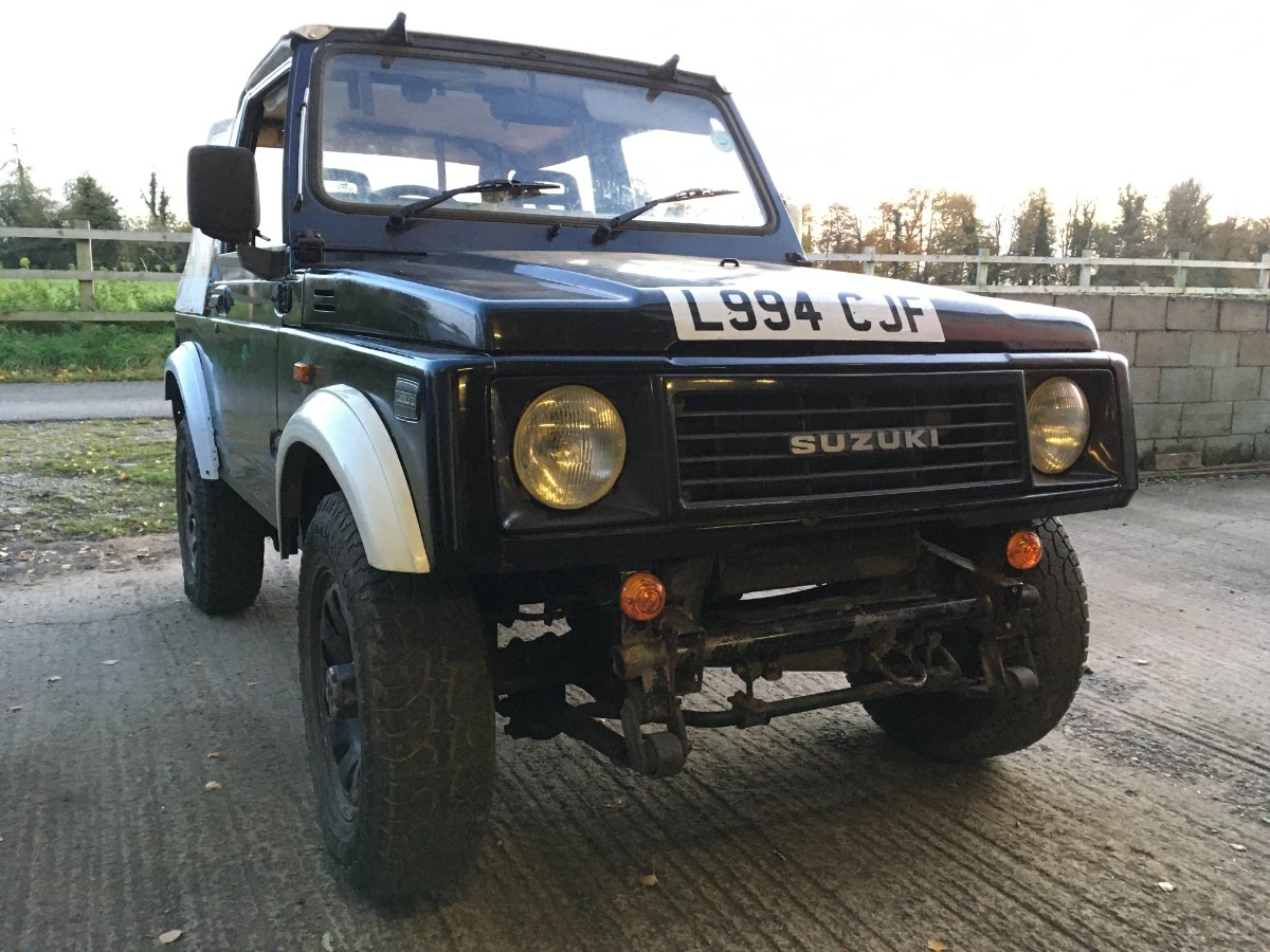

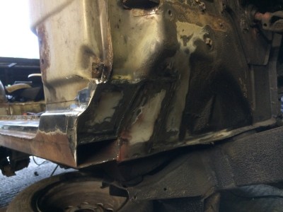

Post by ScottieJ » Thu Oct 17, 2019 10:27 pm

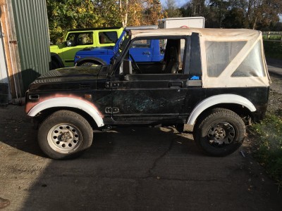

Well this thread needs a bit of an update :lol:
Starting to look like an SJ again and i've got a buyer lined up for her, I'm pretty much just getting it through an MOT and then the new owner will carry on with the mods and paintwork etc.
Arches need a bit of a trim to work with the new sills :lol:

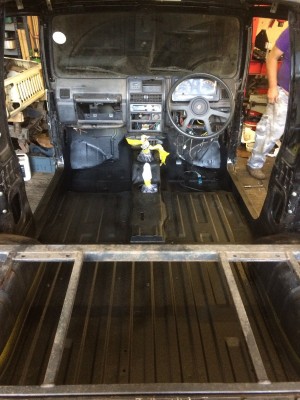

Thats look good Scottie! Whats the plan with the rear tray, that metal frame looks interesting.
Re: Too Many Zooks
Post by ScottieJ » Fri Oct 18, 2019 11:48 pm
The Previous owner did that, it’s an anchorage point for harnesses. I’m just going to leave it for the new owner to decide what to do with it :lol:

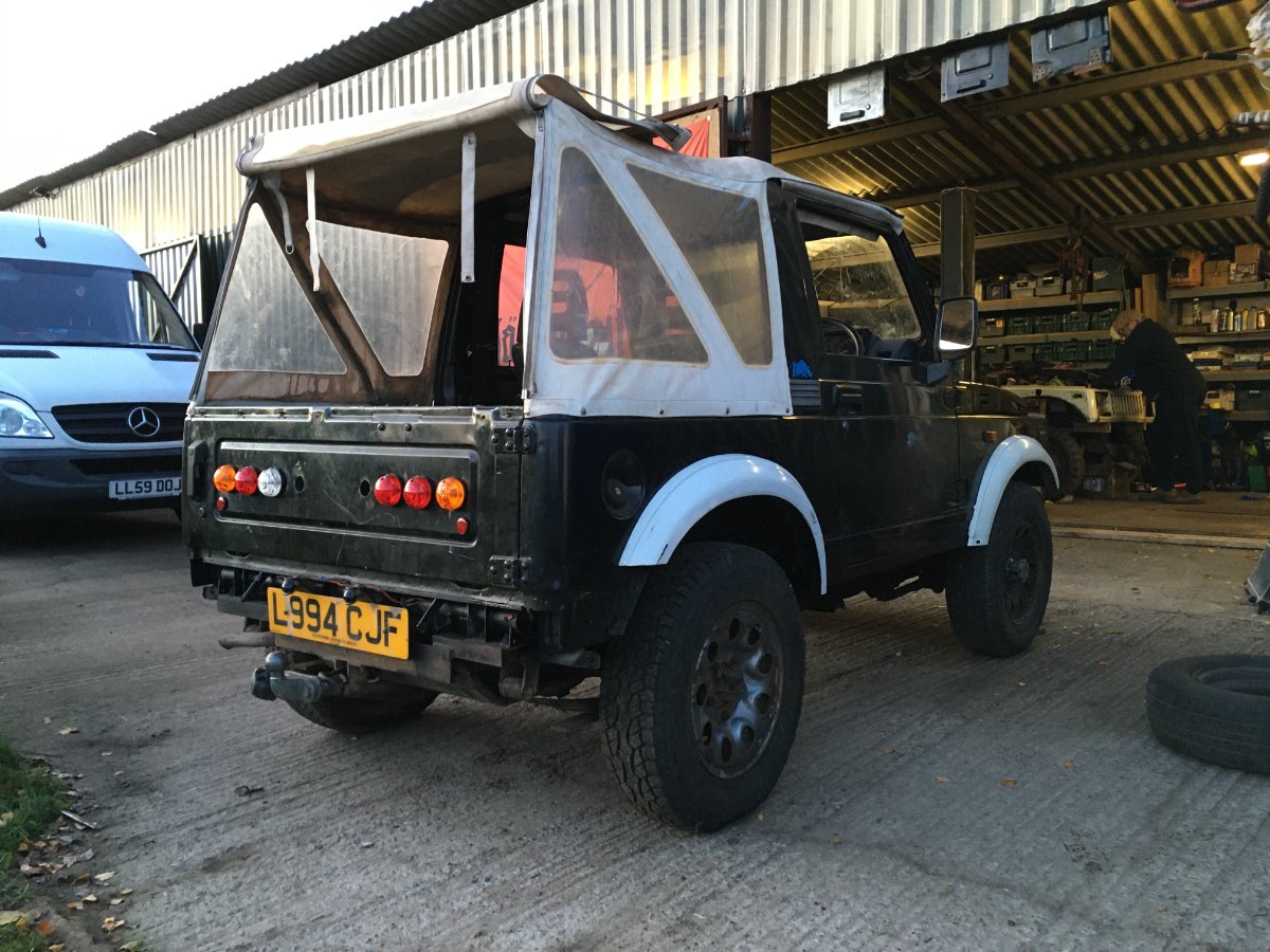

Post by ScottieJ » Thu Nov 21, 2019 10:26 pm
And then it was roadworthy, put an MOT on it and the buyer was straight over to collect. Even with a bit of a rattly engine :lol: I offered to swap it out but Harrison was keen to get it to his so a spare 1.3 went with it in the back. I think he's just joined so hopefully he'll carry on with the build thread. Looking forwards to seeing what he does with it.

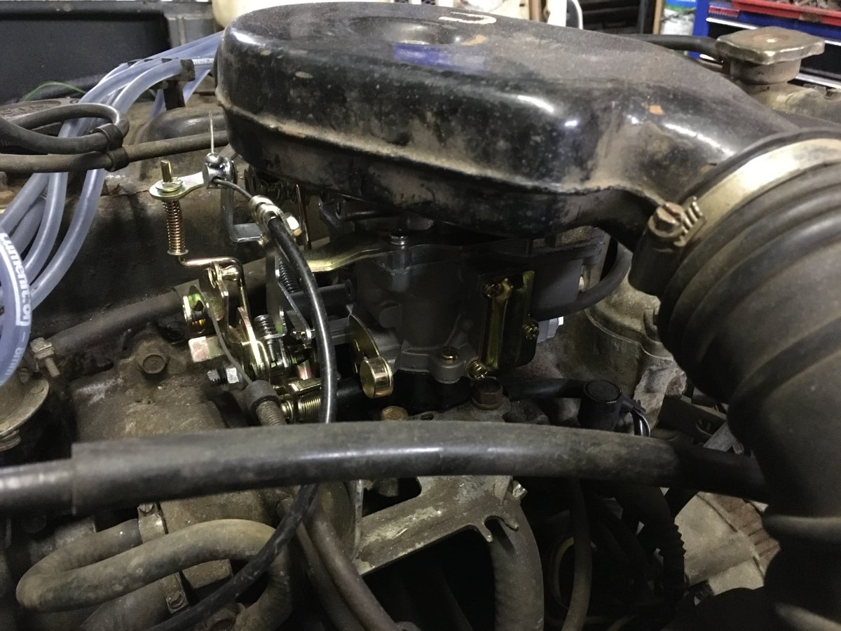

Fitted an ebay Toyota 3k carb to get it running as the stock carb was shot, super simple to fit although it turns out I missed a step and didn't modify the spacer plate, in fact i didn't fit it at all :lol: used the stock sj fuel inlet and modified the throttle cable mount to work, you could easily swap over the actual cable arm onto the carb as well but i just drilled it out on the yota carb so the sj cable fitted. Runs well and pulls very well for a 1.3.
