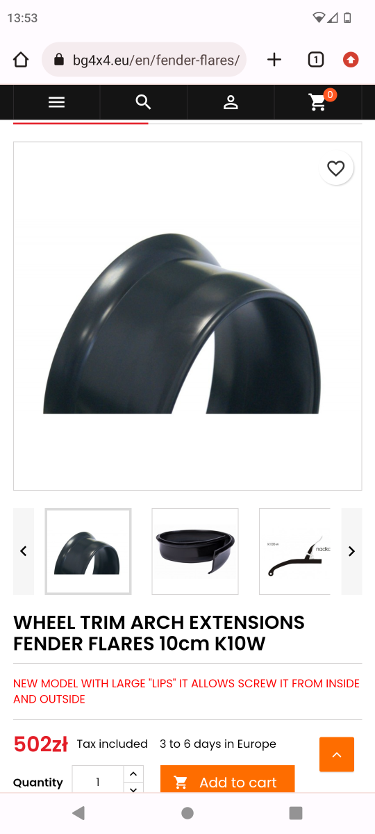

Are those pacer flexy flares?
- d_r_1989
- Winching along now
- Posts: 579
Thanks Scottie, I'm not sure what they're called. They are from Poland. Were £100 posted give or take. https://bg4x4.eu/en/fender-flares/3128- ... -k10w.html
They do different sizes, 10cm is the max I could find.
