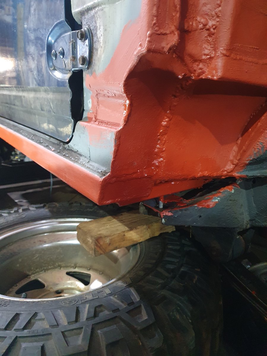

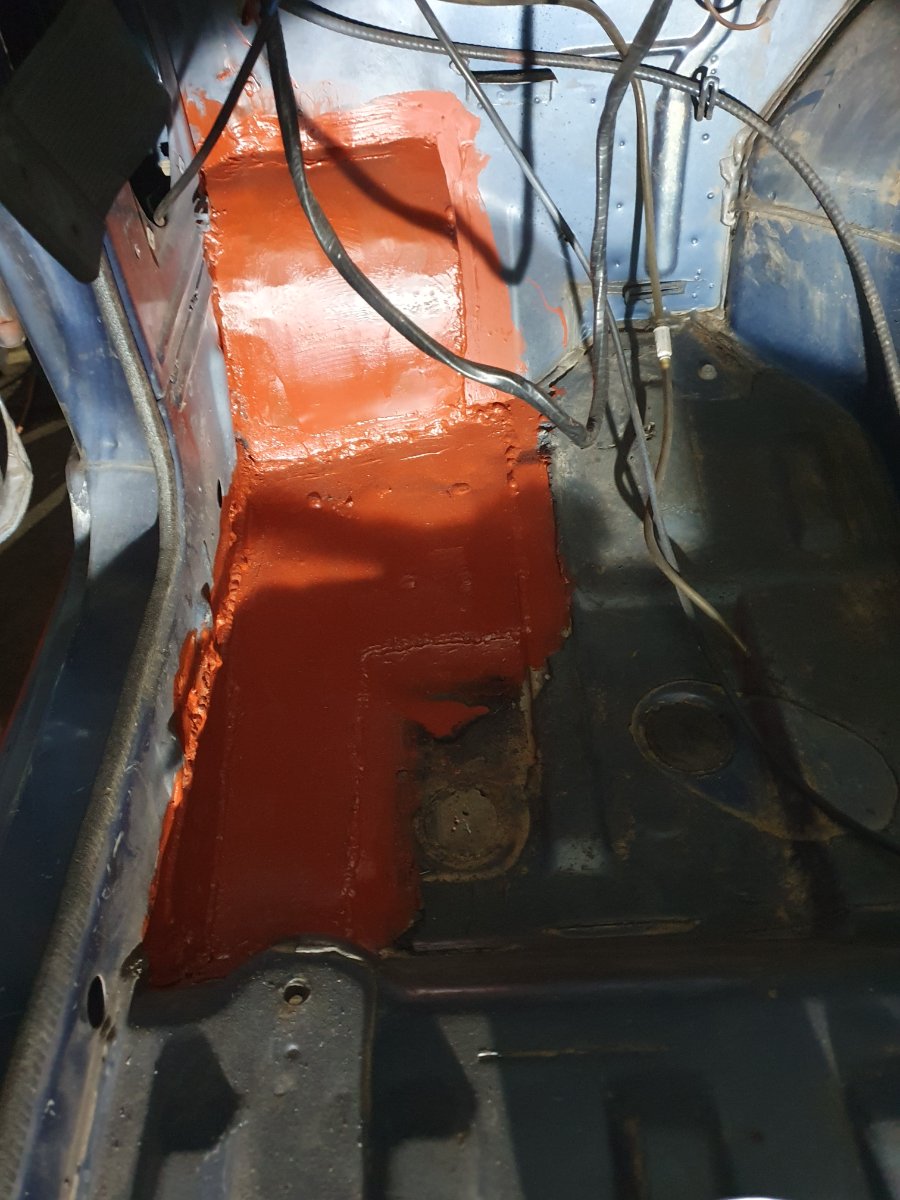

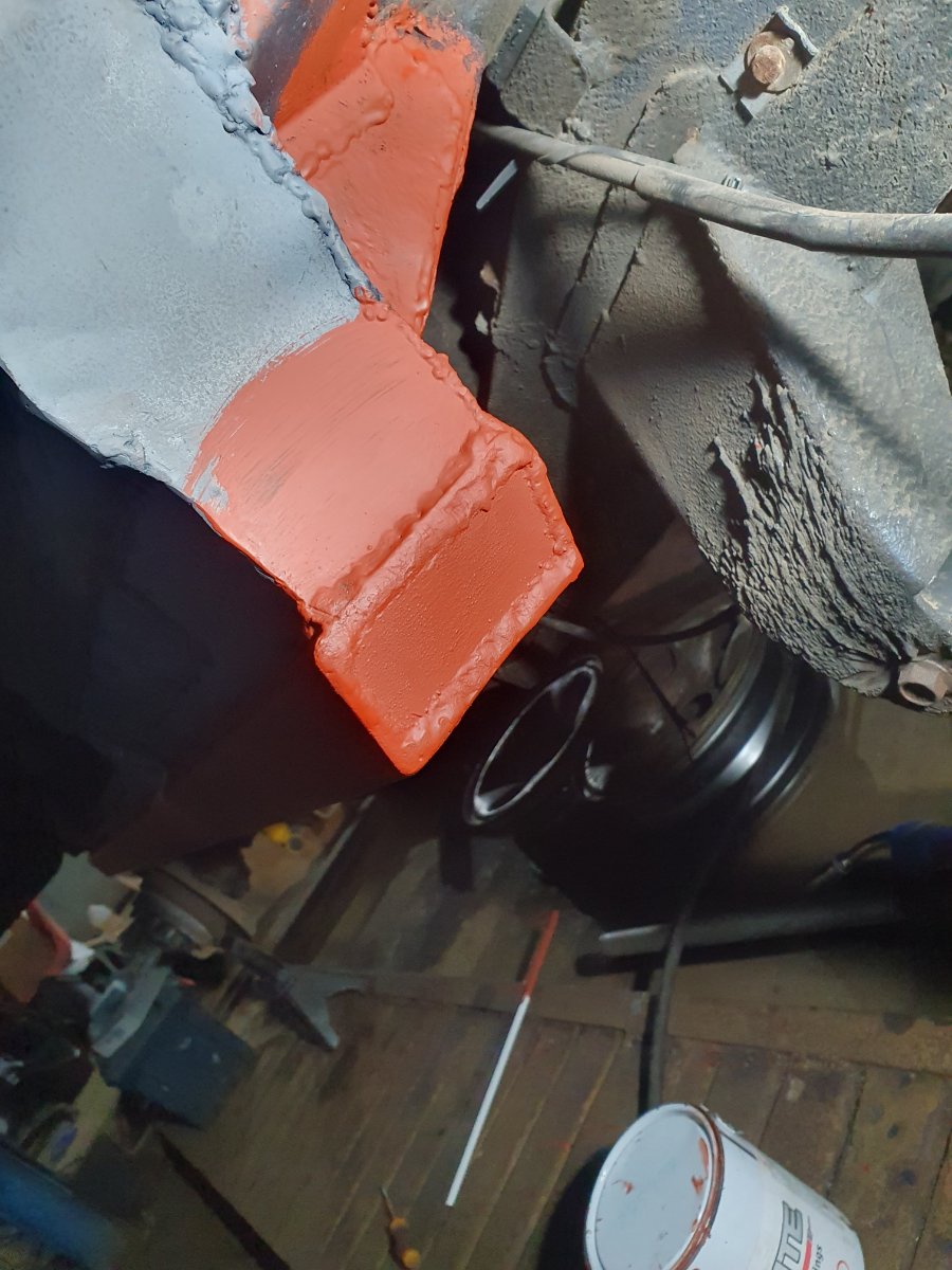

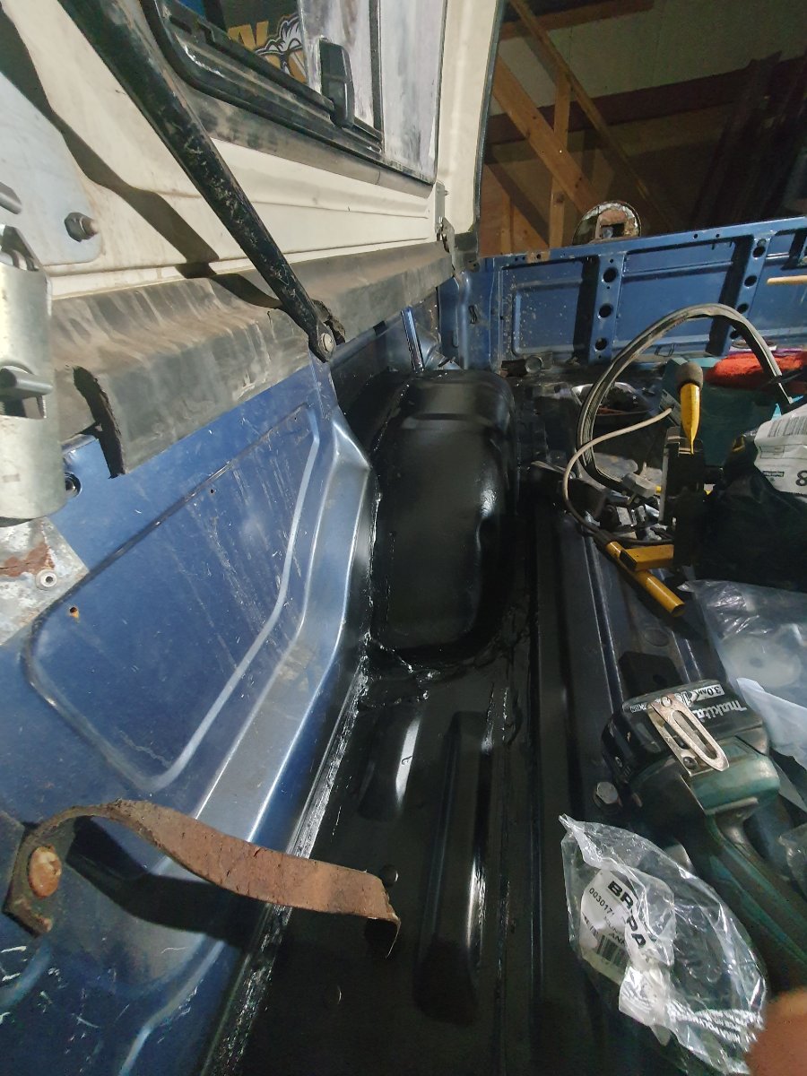

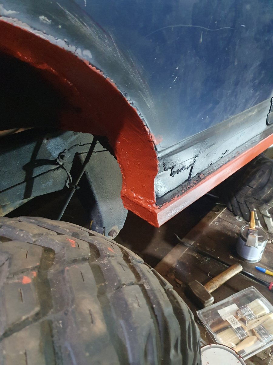

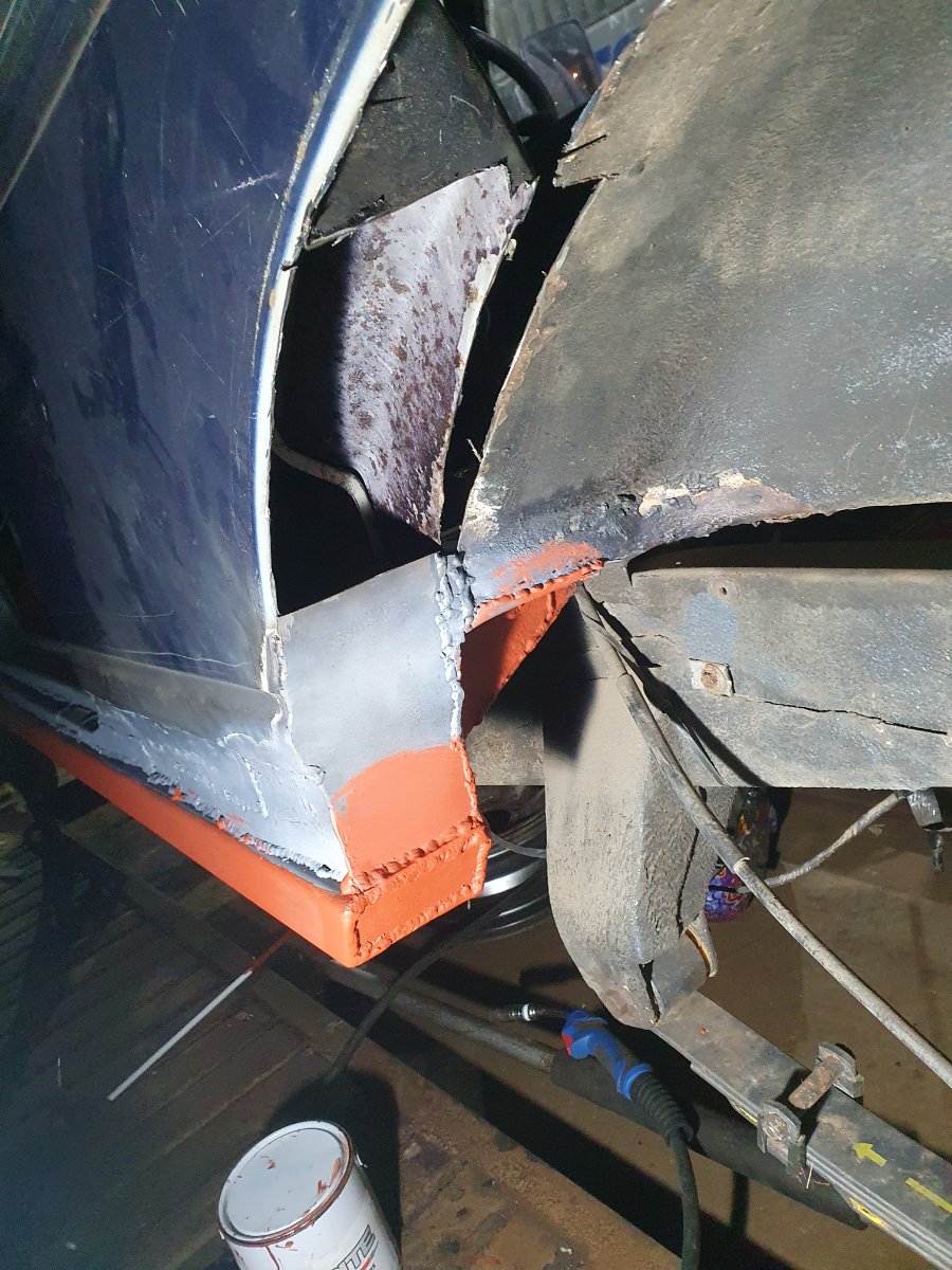

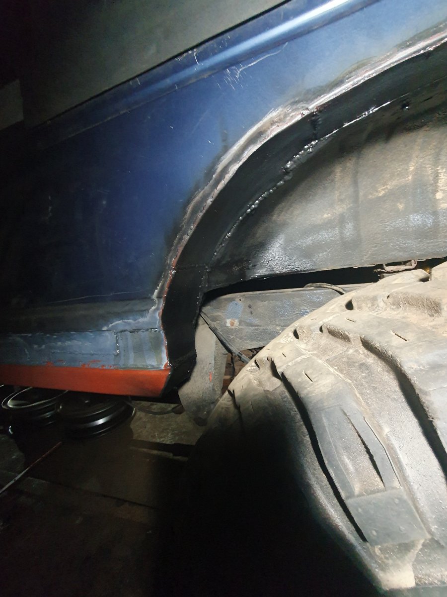

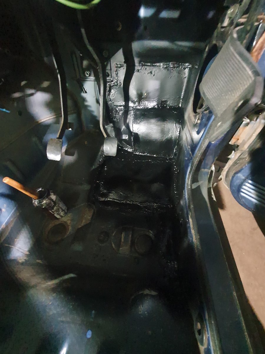

Some updates, I've finished the rear arches the floor and the sills. All welded, seam sealed and coated in red oxide. Inside welding has been painted black to. Going to do some filler work on the outside to make it look abit nicer (may not last long)
