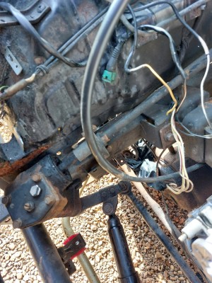

View onto steering box area.
Alternator wiring will require modification as have upgraded alternator spec:
View onto power steering bracket area.
PO altered wiring to oil pressure switch. Not very happy with it.

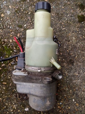

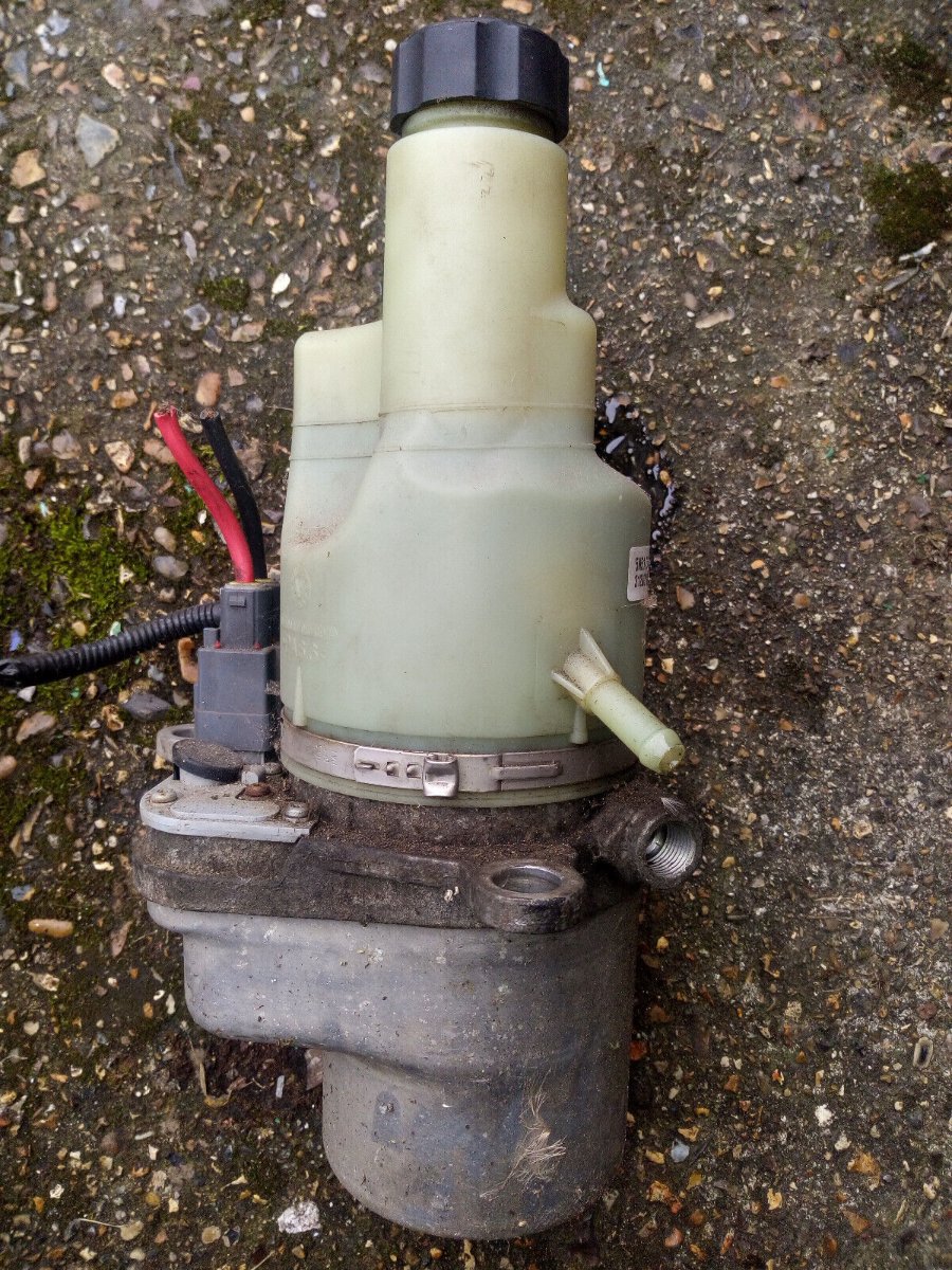

My research into power steering led me to look at the "electric hydraulic" system fitted to various models of Volvo.
Video on Youtube of one fitted to a LHD Samurai.
What else does one do when it is pouring with rain!!
Interesting set up that I shall look at further and report back.
Re: 1991 Santana Samurai
Post by ScottieJ » Thu Mar 28, 2024 7:28 pm
My experience of the electric hydraulic pumps when combined with the Jimny steering box is that it’s usually quite rubbish and the steering is still heavy, people used to use the PSA units.
I would just fit a suzuki based, engine driven pump using a kit. It’s a simple and reliable set up that’s proven to work.
