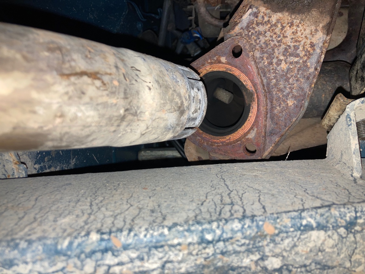

You would think so looking from above but it’s all good.
Just need to nick and modify the downpipe adapter off the J20. It needs a lambda fitting and spacer adding to it to trick it into thinking there’s a CAT still.

Ideal man it did look a little close in first pic. Will the lambda thinking there's no cat effect the running or just throw a code up?

Post by ScottieJ » Thu Apr 24, 2025 10:59 am
Just throw a code up so I’ve got one of those extension things to try 🤞 it works 😅
