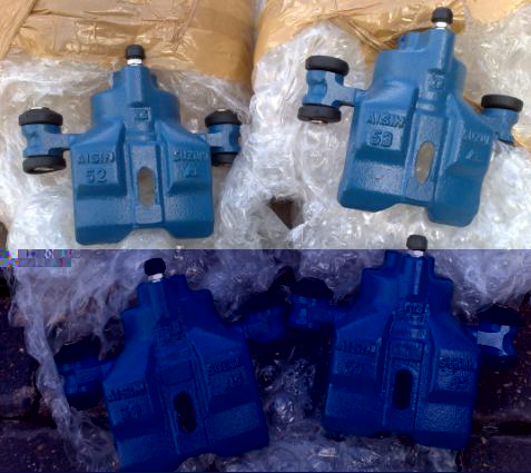

i thor that 2 so iv modded the hanger a bit. (with a hammer big one) to push it ova a bit.
i made it out off the old brum brakes and my donner anus hanger calliper.

also what brakes are you using in rear?
if they are the same size as the front 1's or bigger then the rear will do all the braking first if this is the case then you need to put a bias vavle in the rear brake line then adjust it so the front lock up first
and as scottie says def not sitting right on the disc

this is the set off 4 after the refurb.
driv rear......................pas rear
aisin 52.......................aisin 53
driv frun......................pas rear
aisin 59.......................aisin 57
