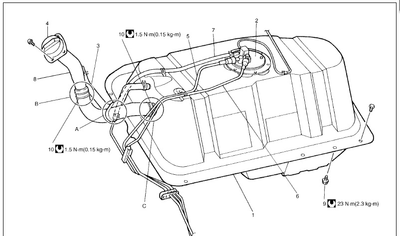

Do you guys think I could get a jimny fuel tank and sender to work on the sj.
Not sure what connections there would be on the sender?
I just can't find a tank close enough to replace mine.
And info would be great.

Are you hoping to use the fuel injection pump ?
I doubt if the fuel senders resistances will match the SJ gauge
Have you got a special tank fitted now, or can you just not find a good original replacement.

Nah I can't find one close enough. For the price of a tank and the fuel picking it up, might as well buy a new one off eBay with delivery, lol
Shame that, there is jimny one cheap down the road from me.
It's the last piece I've got to fit in the chassis. Until I get one it's on stop,
I cleaned the original one up and it's scrap.
