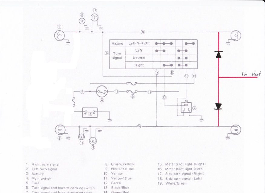

The problem with the hazard light switch is when activated it puts power to the indicator relay and connects both left and right sides together. As this unit only has the one wire supply I can't see how to make the hazards come on. Only one side or the other. You could add a couple of diodes that would make it work. Unless someone can see an easier way I've missed.

Lot of fluffing about though. As you said any light will do just to let you know you've set it on/off.
indicator hazard.jpg (65.66 KiB) Viewed 7613 times
Post Edited due to relay idea being blooming useless :oops:
