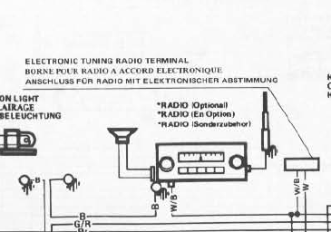

Morning all,
:er:
has any one got any idea which cable from the ignition i need to tap into for the radio to turn on and off?
Cheers
Cheers
Ian. :)
Re: Radio + ignition
Post by twiss » Mon Oct 14, 2013 11:14 am
Radio should have one wire for permanent 12v live (power+memory) and another connection going to your accessories wire to actually turn it on
If you look on the back of the ignition barrel it should be marked ACC
Post by Darrell » Mon Oct 14, 2013 8:13 pm
Don't think mine ever had a connection for an electronic radio (permanent live and switched live).
Mine just had the switched live = White with black tracer.
dazerede
Posts: 2141
Location: cornwall callington
Post by dazerede » Mon Oct 14, 2013 8:58 pm
Yr I had to put a permanent live to my radio the other day as I kept on.wondering why the memory on my radio kept on clearing so I looked on.google and it said u need a permanent live going to the radio at all times so that is what I did
Post by ROBBIE » Mon Oct 14, 2013 11:30 pm
dazerede wrote:Yr I had to put a permanent live to my radio the other day as I kept on.wondering why the memory on my radio kept on clearing so I looked on.google and it said u need a permanent live going to the radio at all times so that is what I did
When yours was built radios were so different to what they are now it didn't need permanent live :lol: If had you truck I would get an original even if it didn't work, in it original mount point, and then a new one tucked away somewhere
