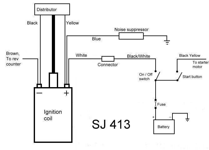

When I bought my Sammi the ignition barrel had been broken out of it.
I'm sure I connected two wires together to turn it over, and I had to make one of the others live to make the ignition circuit. I can't for the life of me remember the details, but I'm surprised one of the electrickery experts haven't come up with the simple error you are doing.
Re: No Spark
If it's a 413/sammy
- 413 Ignition circuit.jpg (23.08 KiB) Viewed 5507 times
