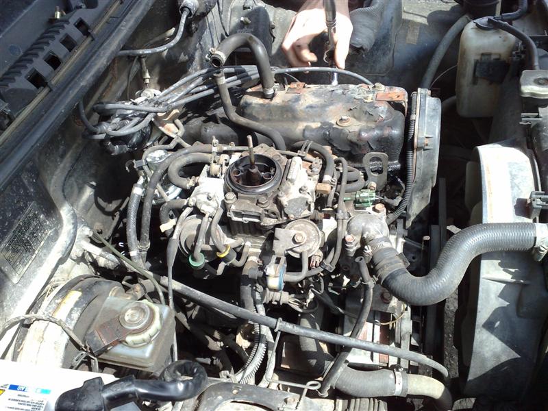

Thanks for the replys guys, it has got calamini lift shackles on the front and its a bit lively on the road, is there any way of cuttin those down abit or make some new ones out of some 6mm plate, the engine i was told was a 1.6 vitara engine must be a 8v running a su carb which also rubs on the bonnet

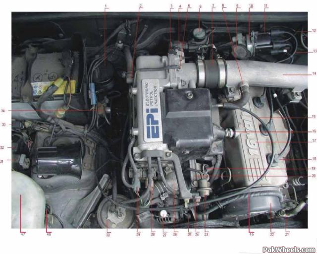

its easy to tell your engine type from the rocker cover
8v:
16v:
There is also an ali rocker cover (not painted like the 8v one above) from a suzuki swift that can be put on the 8v head
Its got small ridges on it like the 16v rocker cover but it doesn't say "16 valve" on it

By the looks of it its a 8v

8V with SU carb, I'd start by checking the jetting and the ignition timing, set up correctly it should go well.
