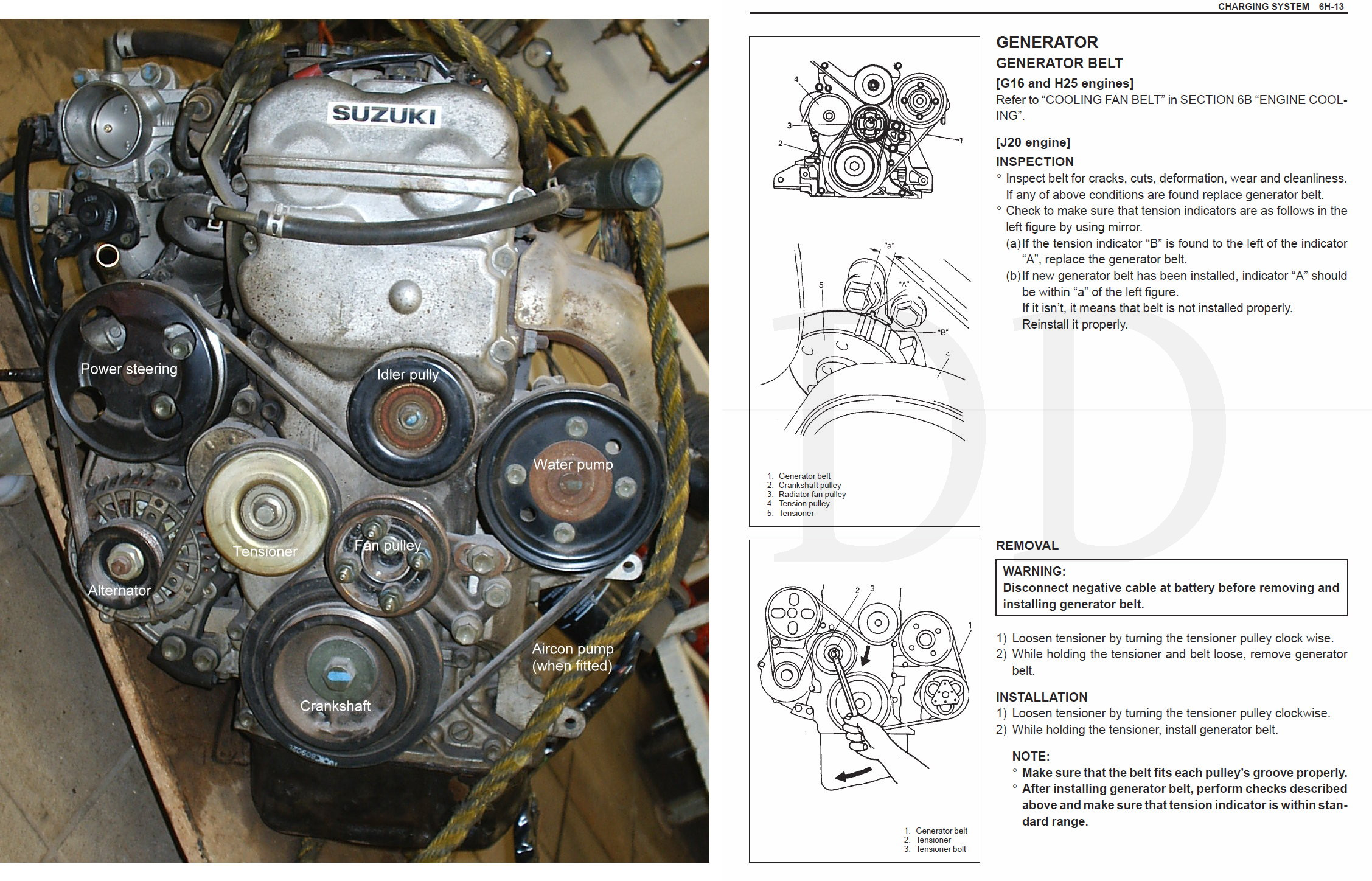

I think that the drive belt on my 04 plate 2.0 gv is getting ready for replacement. There are signs of cracking in it and although i have a downloaded workshop manual i don't seem to be able to find anything that shows this procedure. The engine type is J20A and the car has p/s and a/c. thanks guys.

I assume its sprung loaded, which makes it easy. Well if you have 3 hands anyway ;)
J20 engine generator belt.jpg (837.16 KiB) Viewed 3415 times
