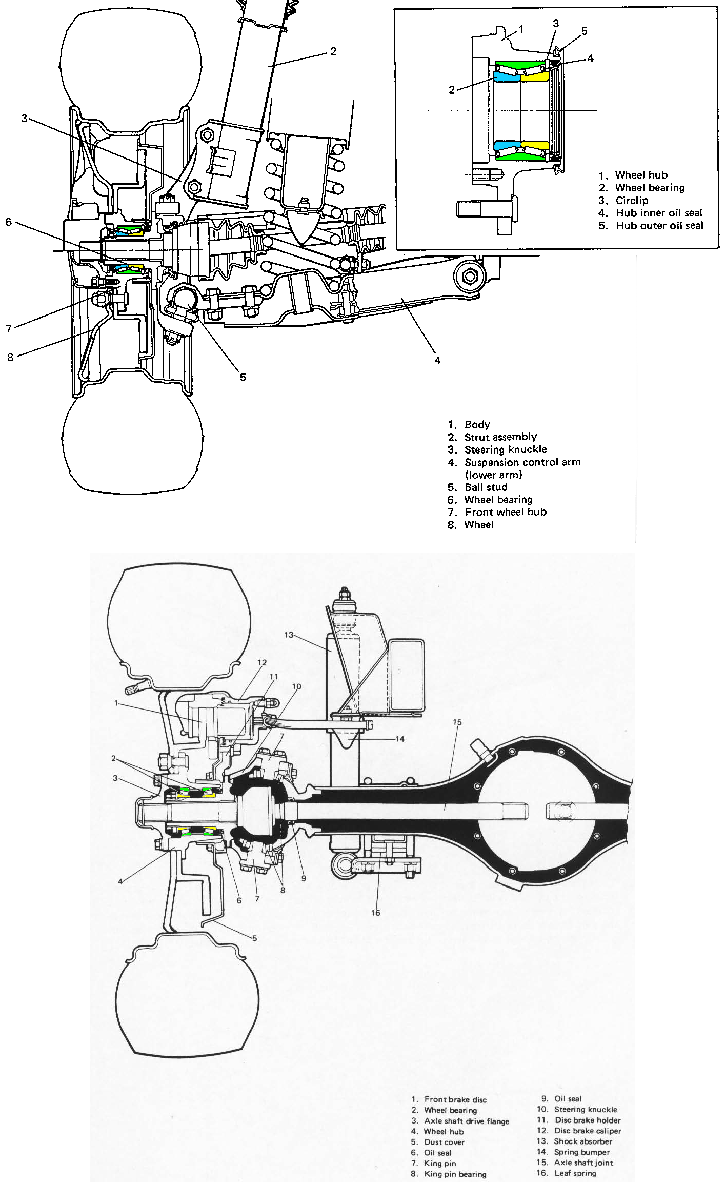

Further investigation and the vitara bearing is the same bore and diameter as an SJ bearing.
Even the Vitara bearing is twice the width of an SJ one.
It just has a one piece outer race. So I assume the inner race is the same for both ??
So we will see ;)
Untitled - 4.png (652.75 KiB) Viewed 2494 times

Cheers Darrell but it's sorted now. Previous owner bodged in SJ bearings into a Vitara sleeve...got the correct Vit bearings on now. You can sleep soundly now!
