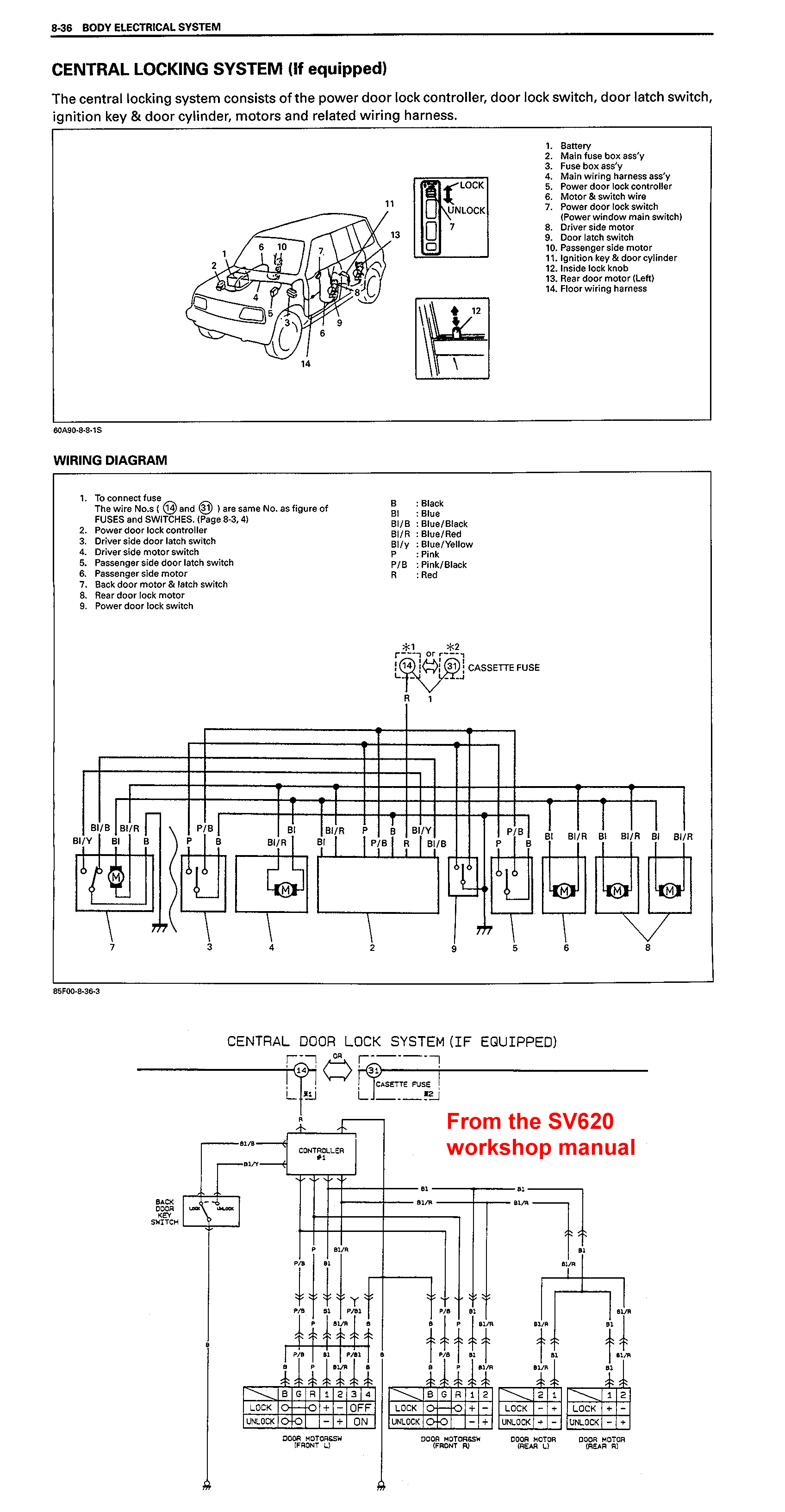

Post by Darrell » Wed Nov 26, 2014 11:54 pm
Apart from a short or possible loose connections I can't help.
Well only with this..........
Suzuki vitara SV620 central locking circuit..png (128.95 KiB) Viewed 3281 times
