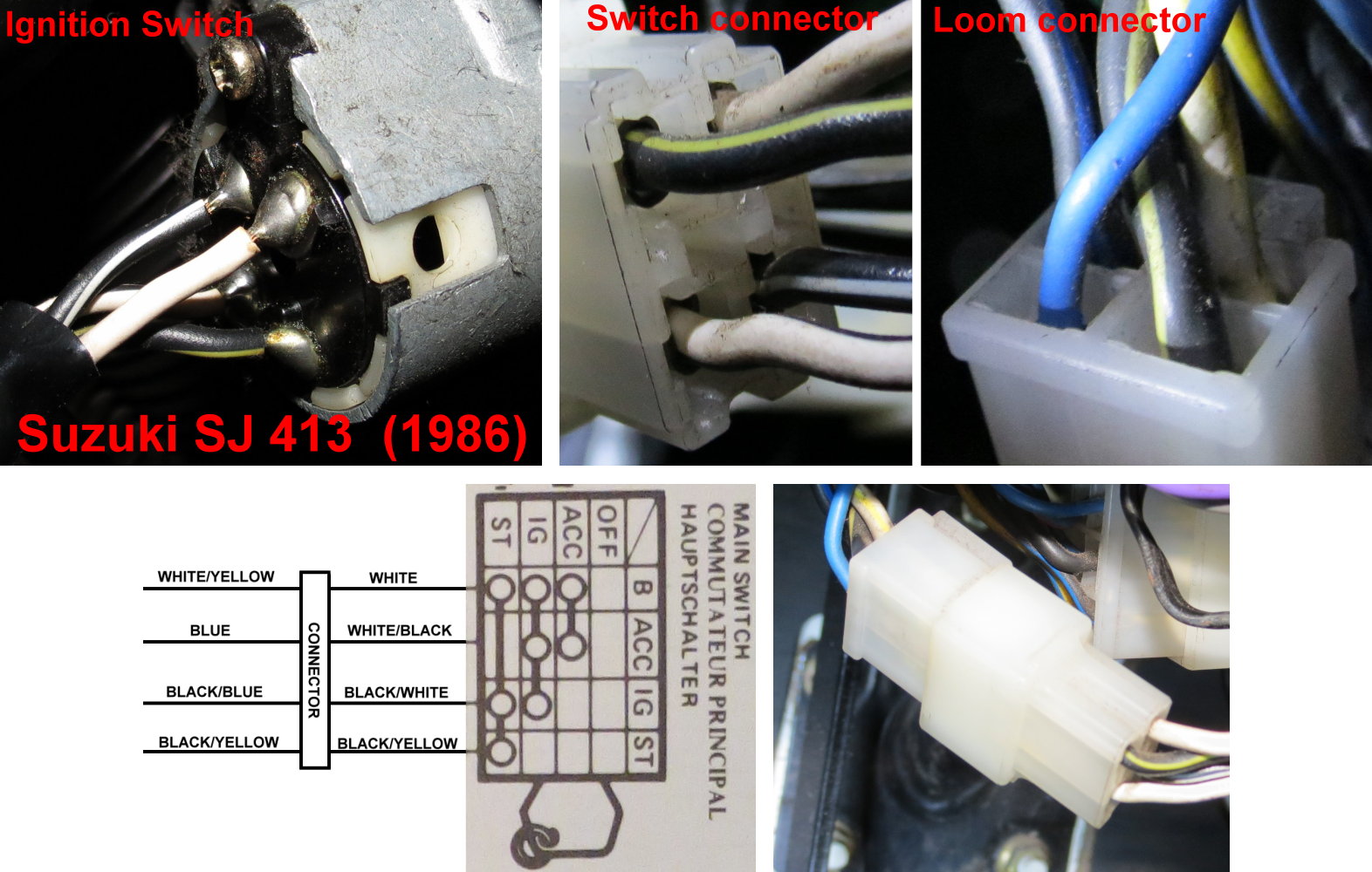

Well I looked at ignition switches online and of course the switch wire colours didn't match the manual.
So thought sod it and went and took some pics, so now done this.
Suzuki SJ413 ignition switch (Jap).jpg (250.16 KiB) Viewed 3645 times
