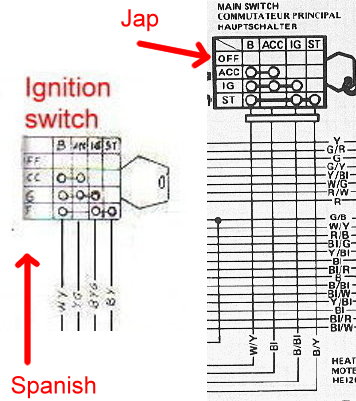

Anyone that's done the 1.6 vitara 8 v conversion in a 410, can you please assist. I am trying to wire up the ignition barrel but I am unsure what wires go to it. If anyone can help, I would greatly appreciate it. I am using the 1.3 Spanish Sammi wiring loom with a 410 barrel. Many thanks, Eddie :D
Re: Ignition Switch
Post by Darrell » Sun Nov 16, 2014 1:40 pm
Not quite sure I understand what your after :oops:
Here is the switches from the Jap and spanish SJ diagrams.
Let us know what colours you have :thumbup:
Ign switches.jpg (43.93 KiB) Viewed 7341 times

Thanks for that diagram Darrell ;) Looking at all the ones I have and that diagram, I have these wires: Black with a yellow tracer, yellow with a green tracer, a white with a yellow tracer and a brown with a blue tracer which is slightly thicker than the rest. All the ones in that diagram apart from the brown and blue wire :S
Re: Ignition Switch
Post by Darrell » Sun Nov 16, 2014 2:48 pm
Looking at the full diagram for the spanish switch the index does not even list a BYG wire colour ,so who knows what that is.
Sounds like it should be the brown/blue as the others match :er:

Ace !! Thanks again Darrel !!! ;) :D On the actual barrel does it matter which of four contacts I solder the wires onto ? I'm not going to use the connector block, just solder the wires straight onto it :)

I wanted the 413 dash, as I have plans for a new control panel and will look better on that than the 410 :) Will bare that in mind with the connector block. There's four points on the ignition barrel where the wires go does it matter which one goes where ?
Posts: 11710
Re: Ignition Switch
Post by ScottieJ » Sun Nov 16, 2014 6:07 pm
Fair enough, tbh I prefer the 410 dash, you should have been able to keep the 410 loom easily enough though, the Spanish wiring loom and fuse box is horrible :lol:
Yes it does matter where the wires go, they have to be in the correct place.

Ha, I did too until I saw some pictures of others 413 dash. I'm going to swap all the original switches to toggles too :lol: I may of been able to keep the 410 loom but that would of involved more re-wiring and I've got a head ache with just this ! Ha. How do I work out which ones go where ?
Posts: 11710
Re: Ignition Switch
Post by ScottieJ » Sun Nov 16, 2014 6:19 pm
Have you already removed the original wires from the ignition switch?
