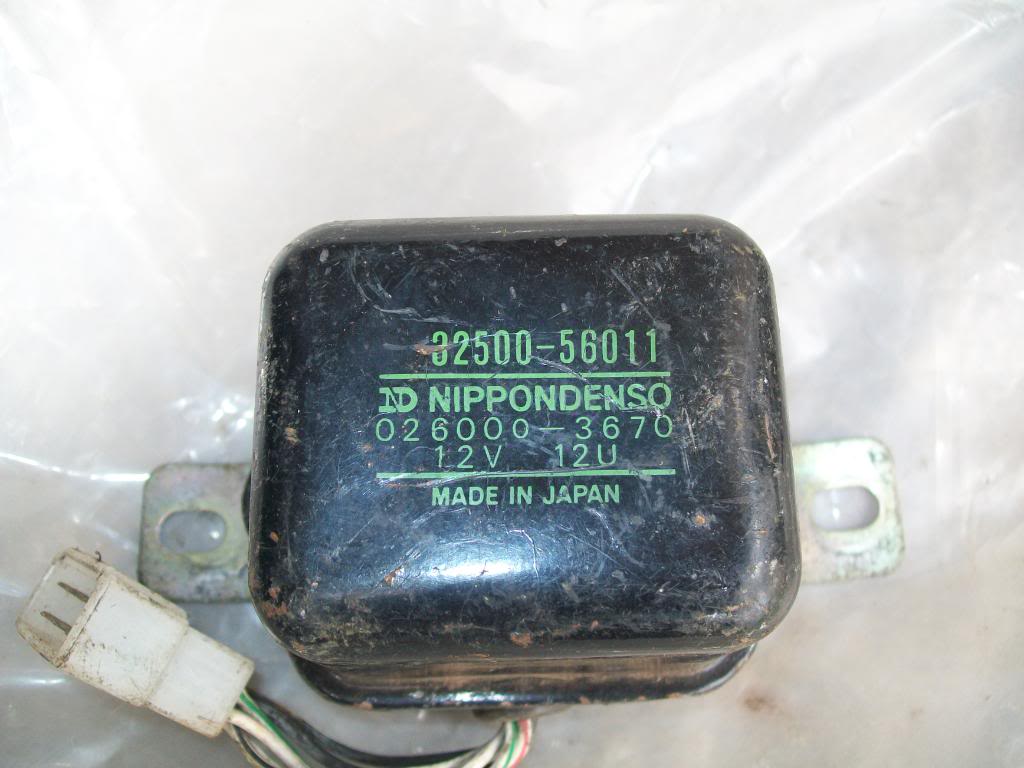

has this box got any thing to do with the running of it? looks sort of important :er:
Re: what do they need to run
Post by Edweird » Fri May 03, 2013 1:36 pm
I think that's the dip-shit unit.
Makes your headlights come on dim when your side lights are on.
Post by Darrell » Fri May 03, 2013 2:41 pm

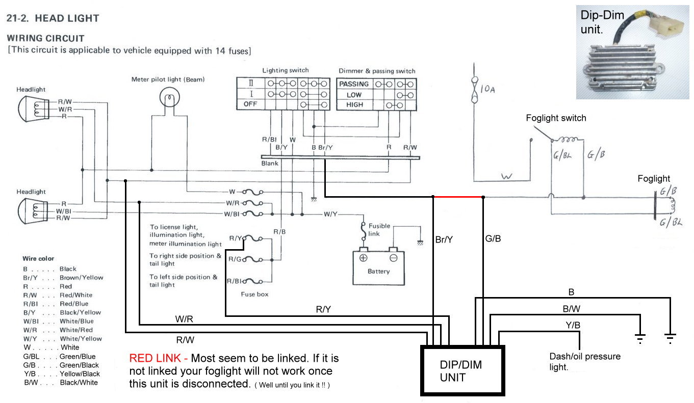

I'm going with ED on this one. The colours and location look right for dip dim unit. However the ones I've seen are different looking to what you have and looking at the wire colours, I think you may have an early 410.
The only problem is if you have an early 410 the voltage regulator is not built into the alternator and therefore that wiring needs to be kept.
Have you got one of these lurking about.
Dip-dim unit
dip-dim unit wiring.jpg (147.6 KiB) Viewed 3748 times

were would i find the box? i'll have a look 2moz been looking at the alternator i got some kicking about might see if any fit :)
will check the light wiring colurs tomorow or fire it up and unplug it see if it cuts out?
