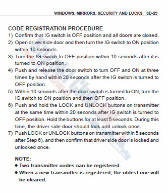

Hi,
On saturday i will be collecting a Grand Vitara,54 plate.5 door.
I have noticed that it only has one key remote 2 button.
Can you advise how to programme another remote into the system so the central locking will work on the second key remote.
I assume it would be in the owners manual but there is no manual.
I have managed to find a second remote & key case which matches the original and i have cut the chip out of the spare non remote key.
Once programmed i will then have 2 key remotes.
Many thanks.
Re: Grand Vitara key remote
Post by Darrell » Tue Apr 01, 2014 8:07 pm
The workshop manual says
code 1.jpg (84.23 KiB) Viewed 5554 times
If you can follow that without making a balls up :thumbup:
Post by ipbr21054 » Tue Apr 01, 2014 8:21 pm
Thanks,that looks a right mess.
Post by Darrell » Tue Apr 01, 2014 8:31 pm
Does this seem a little more sensible to read ??
Probably not :D
in english.png (30.47 KiB) Viewed 5551 times
Post by ipbr21054 » Tue Apr 01, 2014 8:40 pm
Sounds much better.
Do i then also need to do this to the original working key or just the second key.
Post by Darrell » Tue Apr 01, 2014 8:48 pm
Just the second key I would assume.
Never had to do this myself, so not sure to be honest.
Post by ipbr21054 » Sun Apr 06, 2014 6:18 pm
Programmed the 2 keys as advised above and now working fine.
