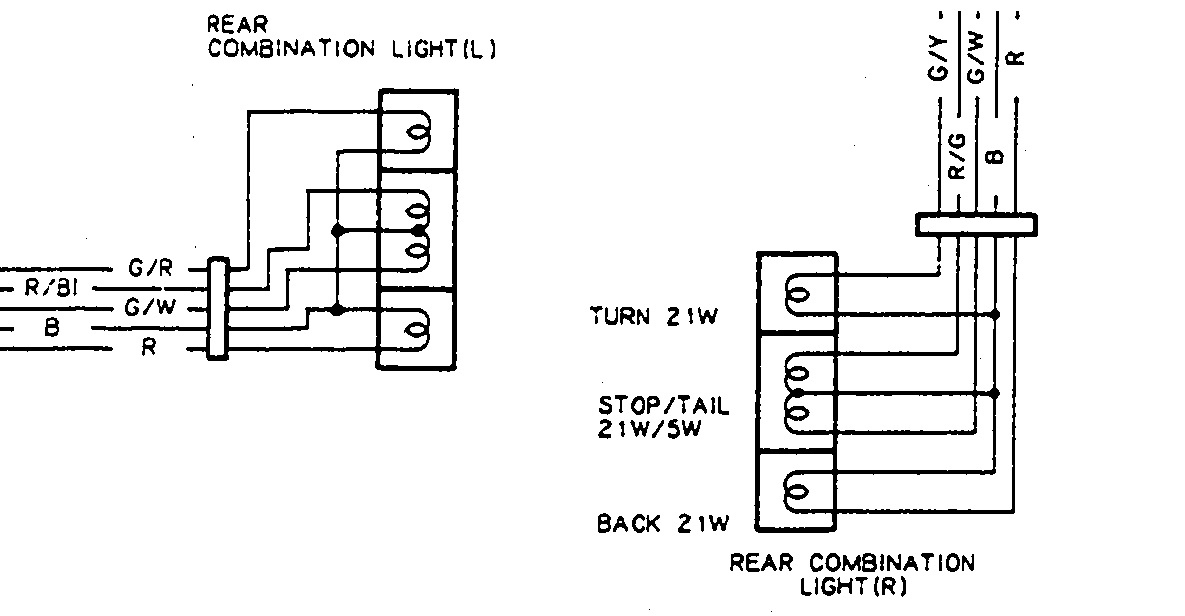

Hi guys, i got a new towbar with twin electrics for my LWB 1993 Vit.
I have not looked at the kit or the wires i will splace into yet (Friday...) but just thought i would ask has anyone else fitted one, maybe made a note of what wires in the car are for what?
Anything whilst fitting i should watch out for?

Heres a wiring picture for the 2 towbar sockets... as for splicing into the existing wires, best bet is a service manual for a vitara... you can find them here:
http://forum.suzukiclubuk.co.uk/vi ... =36&t=7483
Word of advice, its best to strip the insulation off the wires, solder the towbar connections on and reseal with electrical tape
Don't use the clip together scotch locks as they will get mud and crap in them, then the wires will end up corroding
It's worth buying a soldering iron if you dont have one! :)

The wiring colours are the same as on my spanish 93 SJ so if your vit is a spaniard this might be it
