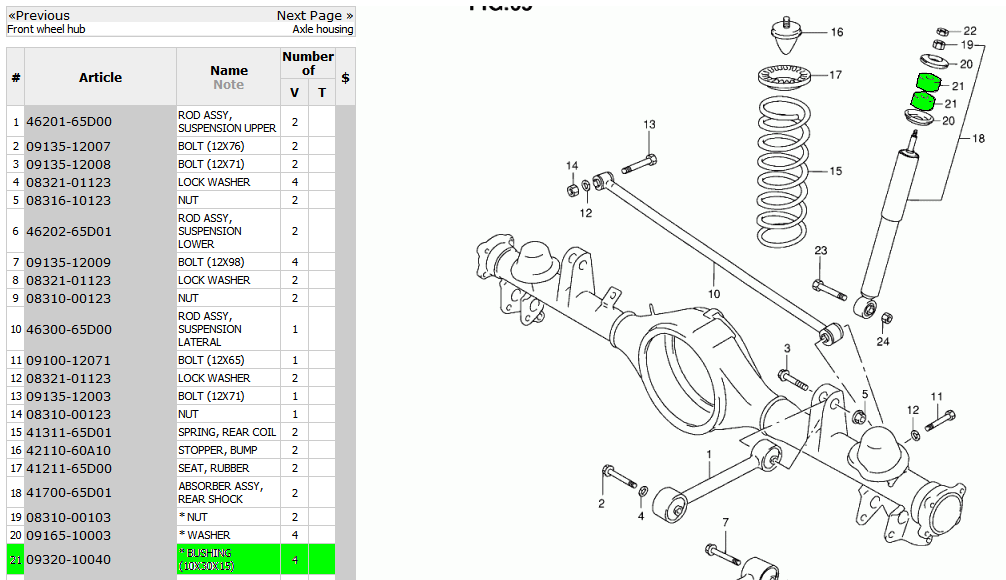

Re: Rear shock absorbers appear loose.. Help please
Might be worth getting some polybushes if you can as they will last longer
Thanks for the diagram..!! The top bushes are gone... And there's only one nut on each. No sign of fluid from them at all.
By plastic, I mean, over the shock absorber there is a very thin flimsy almost plastic tube around it. I have just had a look with my torch and the bushes are barely there.
Are they easily replaced?
