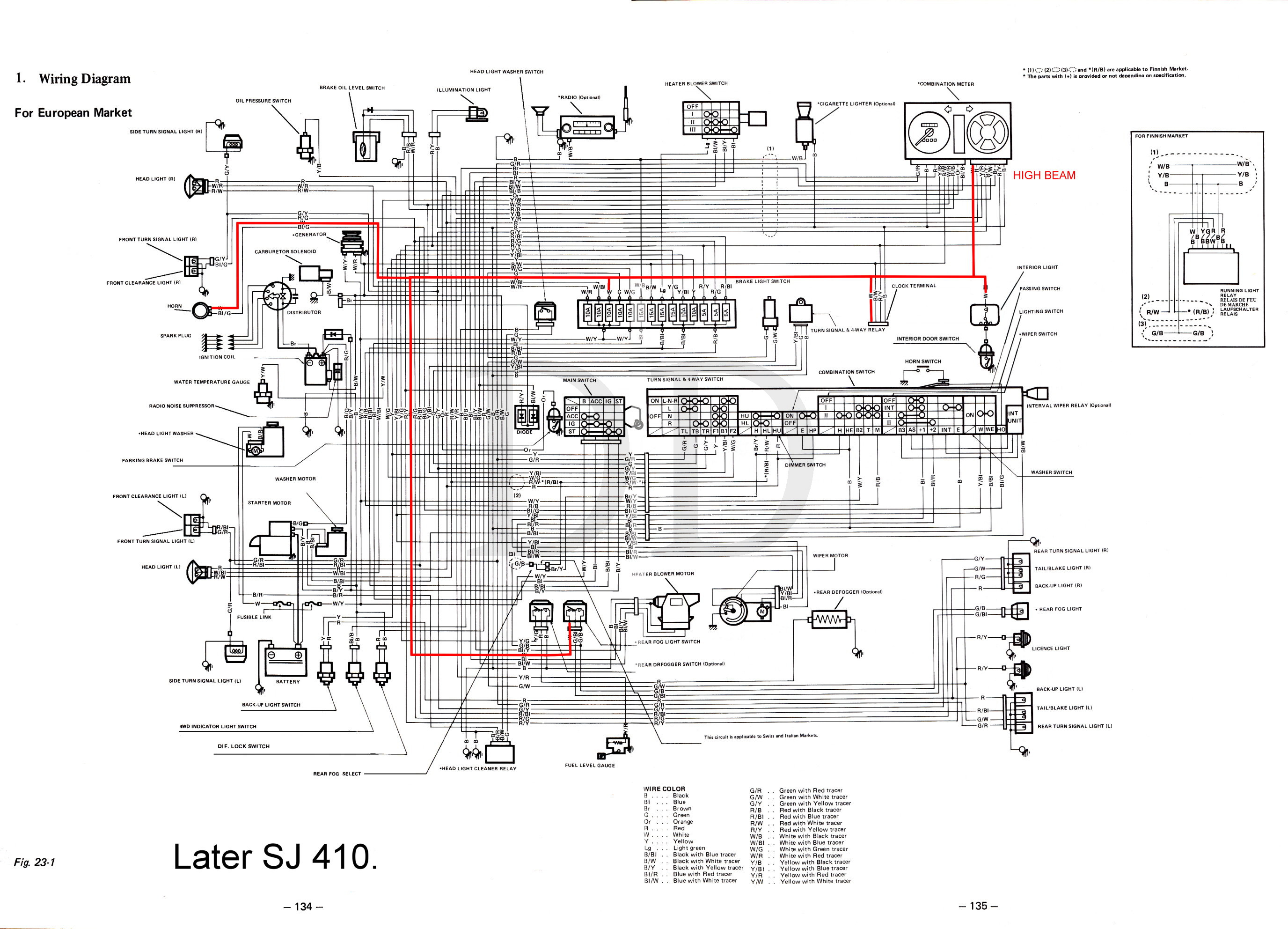

Just took dash of my truck and found out the wire going from the clock to the fuse box has burnt right out and the interior light doesn't work and the horn doesn't work also what else does the fuse do as looked in the Haynes manual and it also says the brake light and main beam light goes to the fuse is this correct

Re: does this interior clock have a fuse ???
Not the brake light according to the diagram.....
- 410 wiring diagram.jpg (1.01 MiB) Viewed 6748 times
That's alright then cheers for the diagram mate cheers
