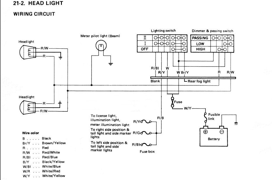

This is the wiring for the Japanese built models. IE switched earth type.

Thanks Darrell - mine's Spanish but they may be the same? From above i still don't understand every terminal being earth when off - wondering what that bar thing with 'blank' under it is. Told you I was no sparkie :D

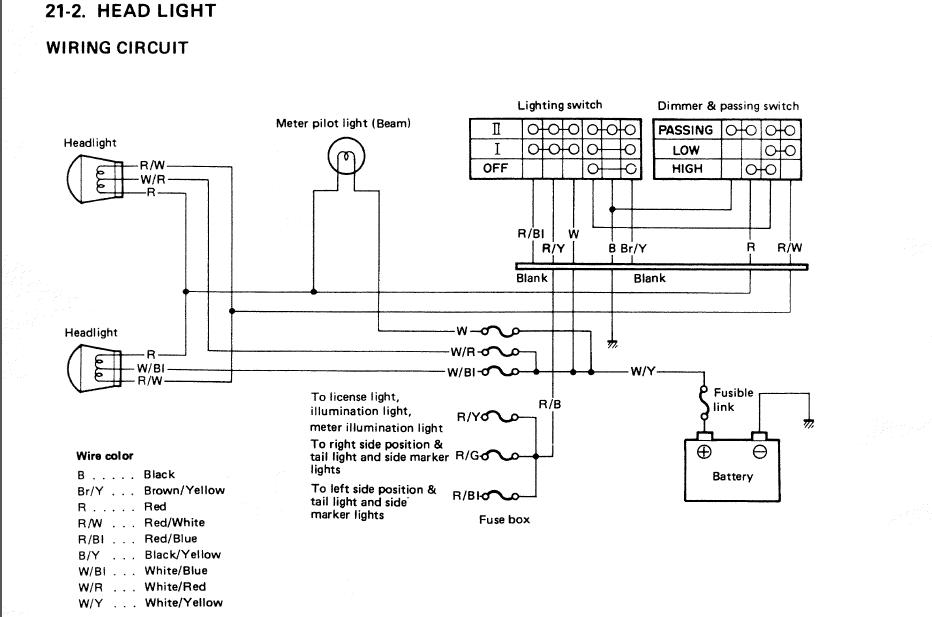

This is my take of the Spanish wiring (Normally switched live).
Don't hesitate (anybody) to comment if you see I've screwed up.
I can't guarantee all the wire colours are correct as I can't read them for sure :oops:
My take on it.
My take on it.
Spanish headlight wiring..jpg (72.6 KiB) Viewed 5834 times
Original diagram
Original diagram

Thanks for help. So I need to find this running resistor and try with it disconnected. Wonder what it does and is it a part of lighting cct as I don't see a resistor anywhere in diags above.
Good point re disconnect the other light, that will explain the earth everywhere I expect.
