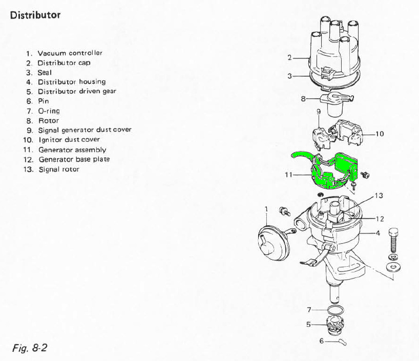

Post by Darrell » Mon Aug 25, 2014 12:01 am
On some I believe the generator and ignitor are connected by 2 screws (as shown above) but not listed as separate part numbers.

Post by Rhinoman » Mon Aug 25, 2014 8:12 pm
I think the 'Do not Remove' marking gives a clue as to why its not available separately, I would recommend seeking out a used, complete, distributor.
