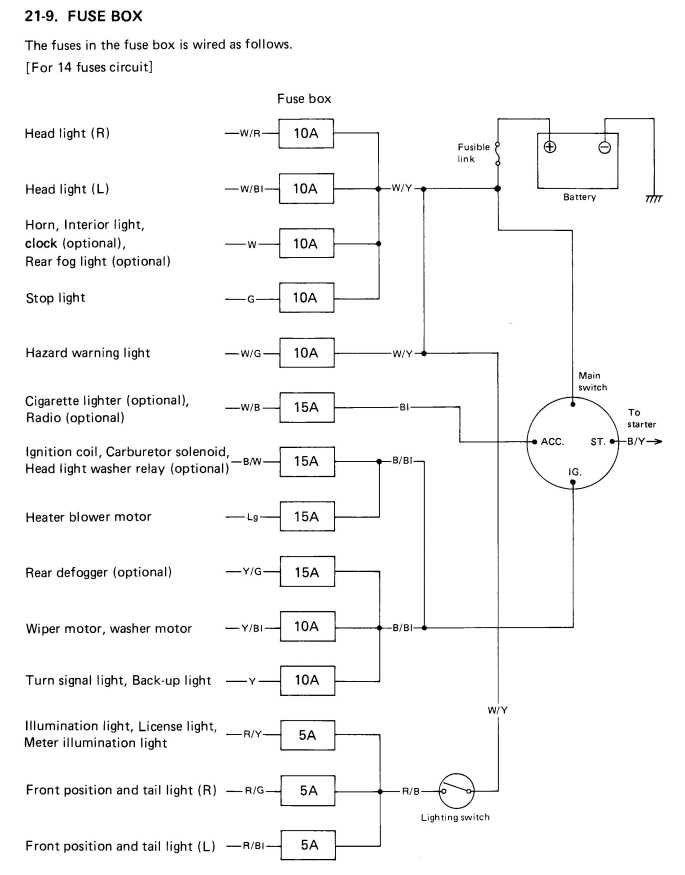

Hello folks, sorted out the 1.6 engine and now I am at the point of wiring it back up, though unfortunately missed placed it and can't find it anywhere. Can I use the 410 one if so what connector block/colour wires would normally go to the ignition barrel on a 1.3 loom ? Many thanks, Eddie :D
