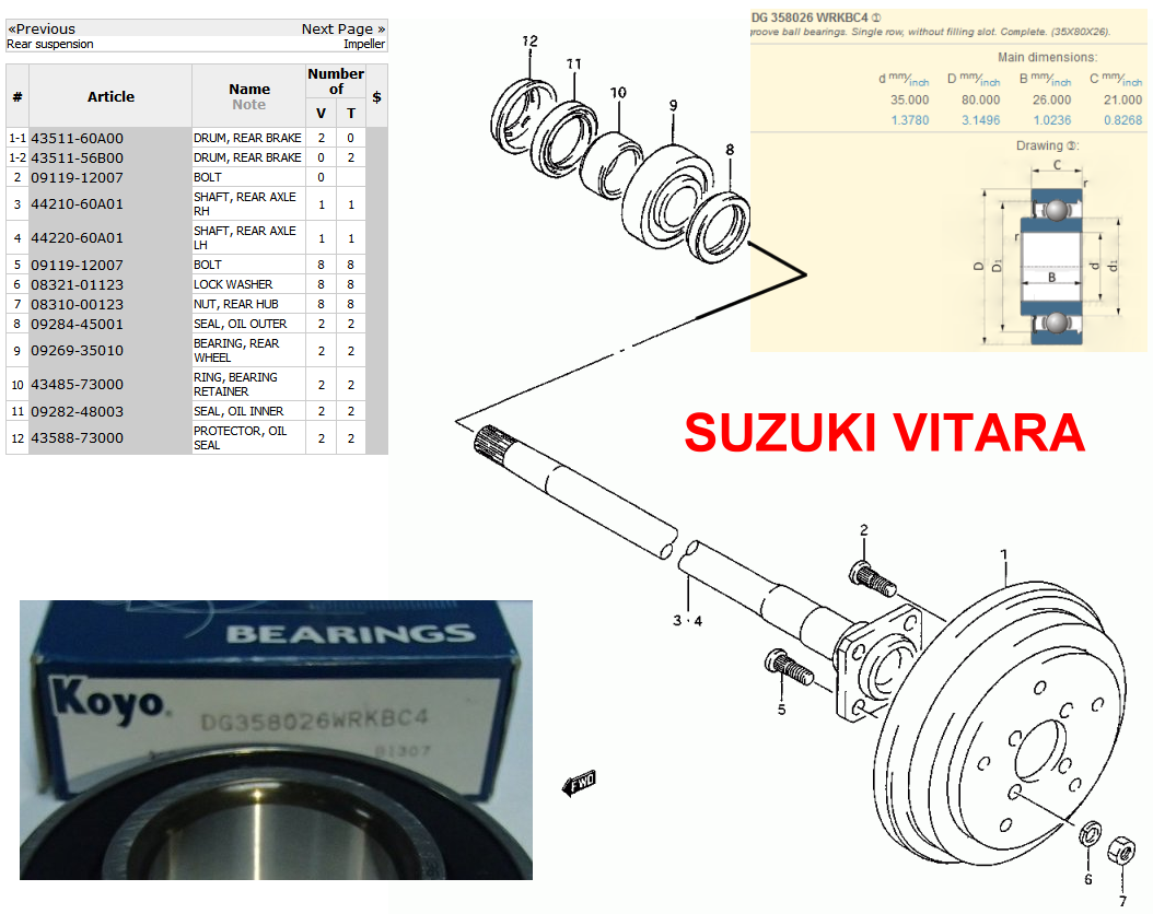

Does anyone have the dimensions of the vit rear wheel bearings to hand...and possibly the outer seal?
Looks to me like the locking collar and inner seal are the same as Sj items, but i'm rebuilding a hybrid axle for someone and i'm not sure if vit rear bearings are the same size as sj ones, I don't think they are.

Post by Darrell » Thu Oct 16, 2014 9:44 pm
Guess what..................
Vitara rear wheel bearing.png (265.77 KiB) Viewed 4926 times

I could find very little info on the outer seal, but what I did came back as 45/59/8.

Cheers Darrell! I often wonder how you manage to find stuff like this! I was searching for quite a while with no Luck :lol:

The sizes are a little different and the Vit ones are a sealed unit, SJ ones are taper bearing. I know this from fitting one to my Vitara...was a royal pain!
