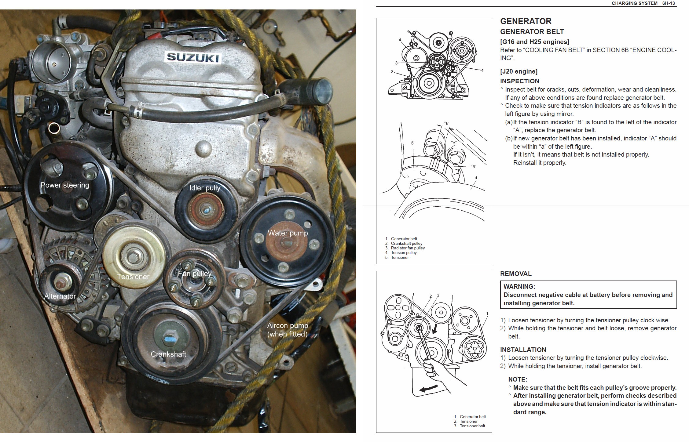

On closer inspection, the serpentine belt ( belt in engine bay at the front of the car, presumably the serpentine belt?) looks a bit worn/cracked. Should I get this changed, if so, how much am I looking at? Also, is it called the serpentine belt? I don't want to look like a tit when/if I mention it to my local garage?!

if it goes over pulleys on both sides of the belt then its a serpentine.... if not i'd just say its a fanbelt

If its a J20a engine then it will be a serpentine belt :doublethumbs:

Welcome to the club.
Don't know about the cost but it shouldn't take very long.
J20 engine generator belt.jpg (657.49 KiB) Viewed 4546 times
