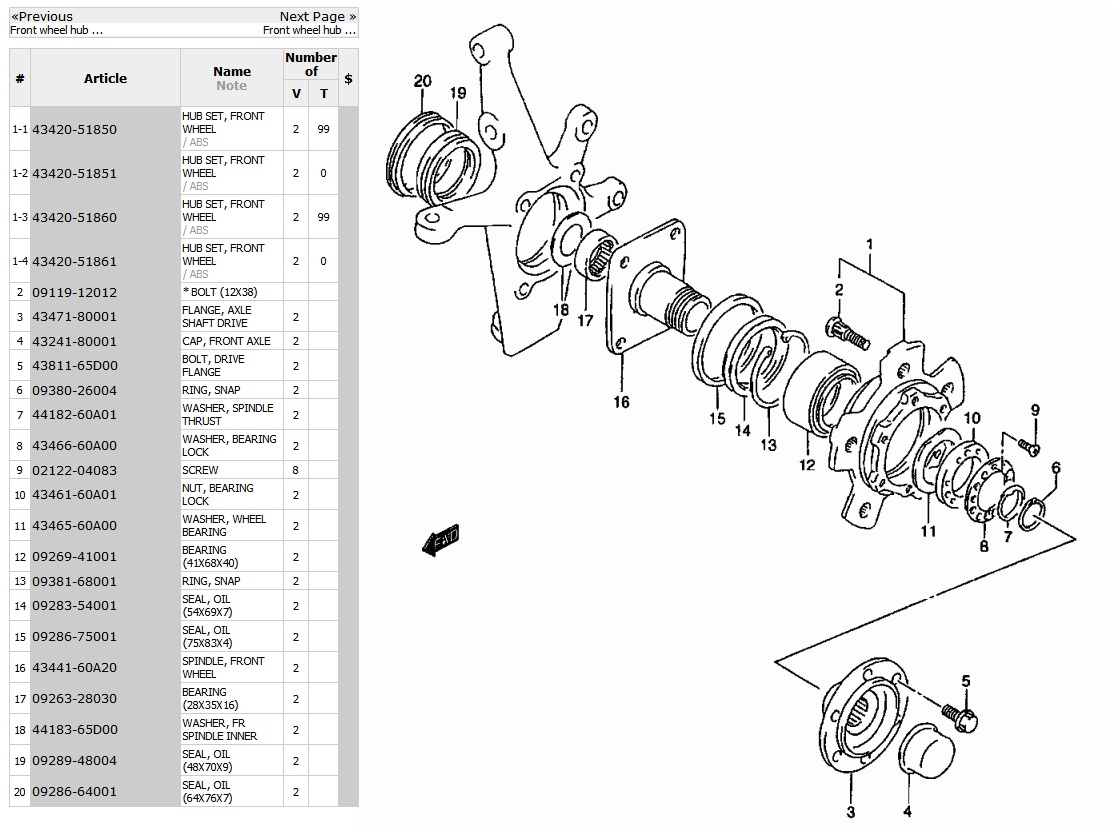

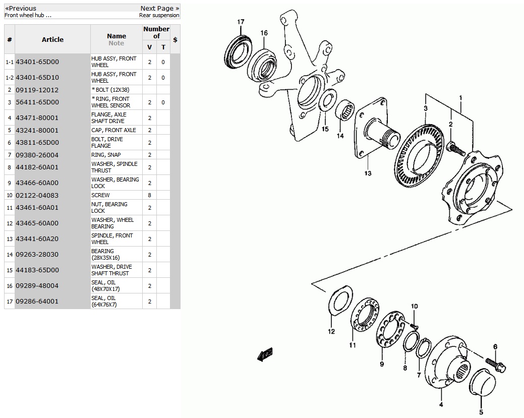

I would leave them alone...
You need a special tool to remove the hub nut and then the bearing is a sealed unit (1999-2000).
Same tool is needed for the 2000 onwards ,but the hub is the bearing, so needs replacing as a unit when required. It is open on the nut side but you won't get much grease in it.
Yours should be the early type anyway ;)
Diagrams of course.........
1999-2000 GV.jpg (213.03 KiB) Viewed 5248 times
2001 onwards GV.jpg (178.82 KiB) Viewed 5248 times

That looks all to familiar...it is a bastard of a job but if they aren't an issue leave them alone. If they are fubar then it's a blow torch and lots of swearing.
